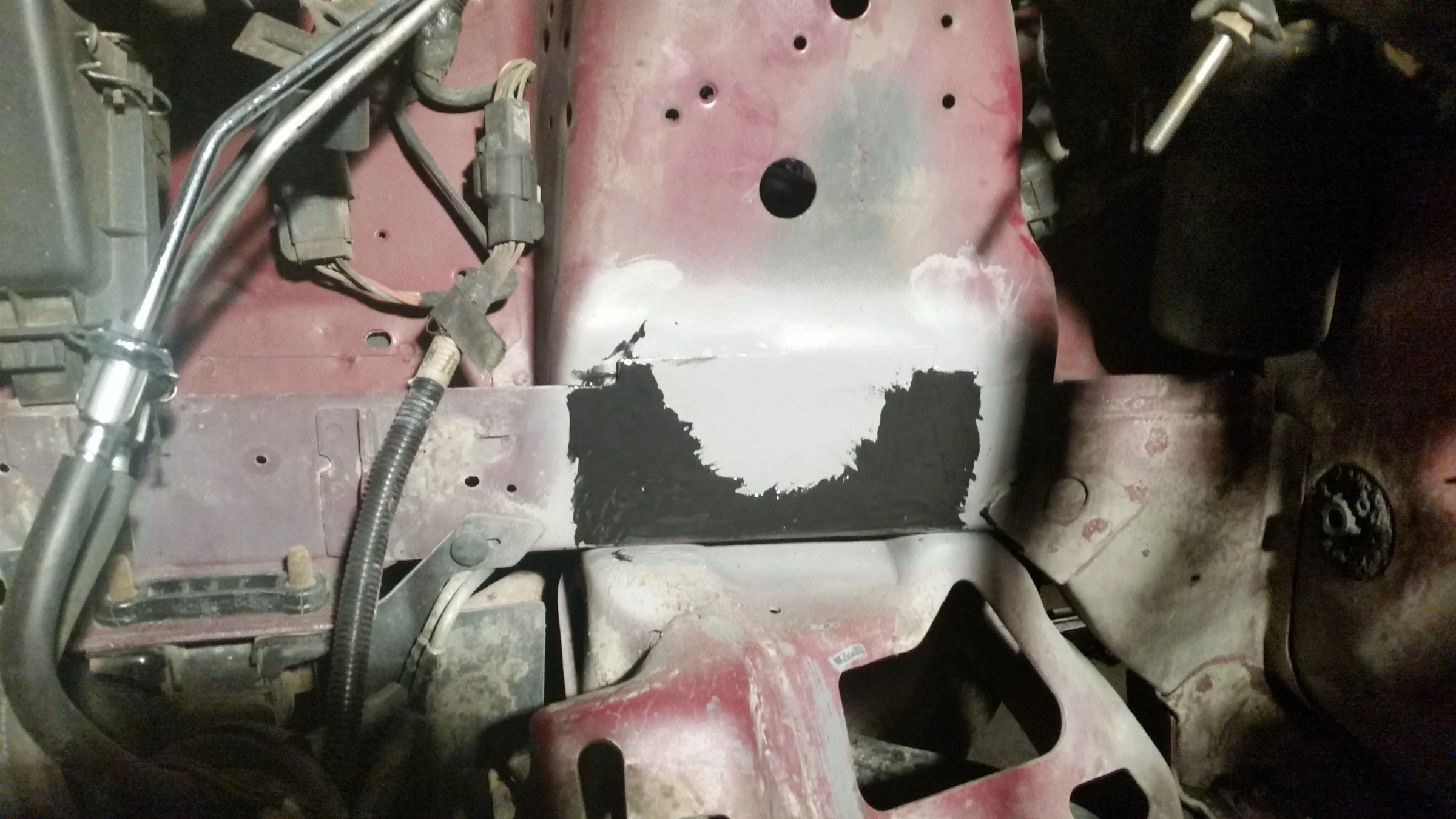

Got started welding the first plate in to fill the shock tower hole. I have a lot of pin holes, and am slowing filling them. I have to grind the welds back, so the replacement frame rail plate can also fit in and be butt welded around the edges. What a PITA getting the pin holes filled. Considering spraying it with etching primer, and smoothing over the pin holes with left over PBA from the bumper mod. Obviously I have to leave the outer edges bare metal for the next plate to weld to, but am I being too lazy wanting to fill those holes with something else for this inside plate?

I'll be honest, on the right side I have a bigger gap than I should have started with. So those holes are because I have too big a gap to fill, and blast through when trying to fill them. I should have cut another tighter fitting piece, but am too far along to go back now.

@Davedacarpainter , what are your honest thoughts of my work so far?

Honestly Nick, it looks real nice so far. Don’t obsess with the little holes, filling them in isn’t going to add strength.
Just spray some weld through primer on the plate and weld the next one on.
God gave grinders to us that don’t have the prettiest welds. You mainly want solid welds. Besides, even if you could lay out a weld that would leave us all in awe in that area, you’d still grind them since you’ll want it smooth there.
When you’re done get some of that rattle can spray that has a tube attachment that’ll allow you to spray inside the subframe to cover the back sides of the welds.
You’re doing great.

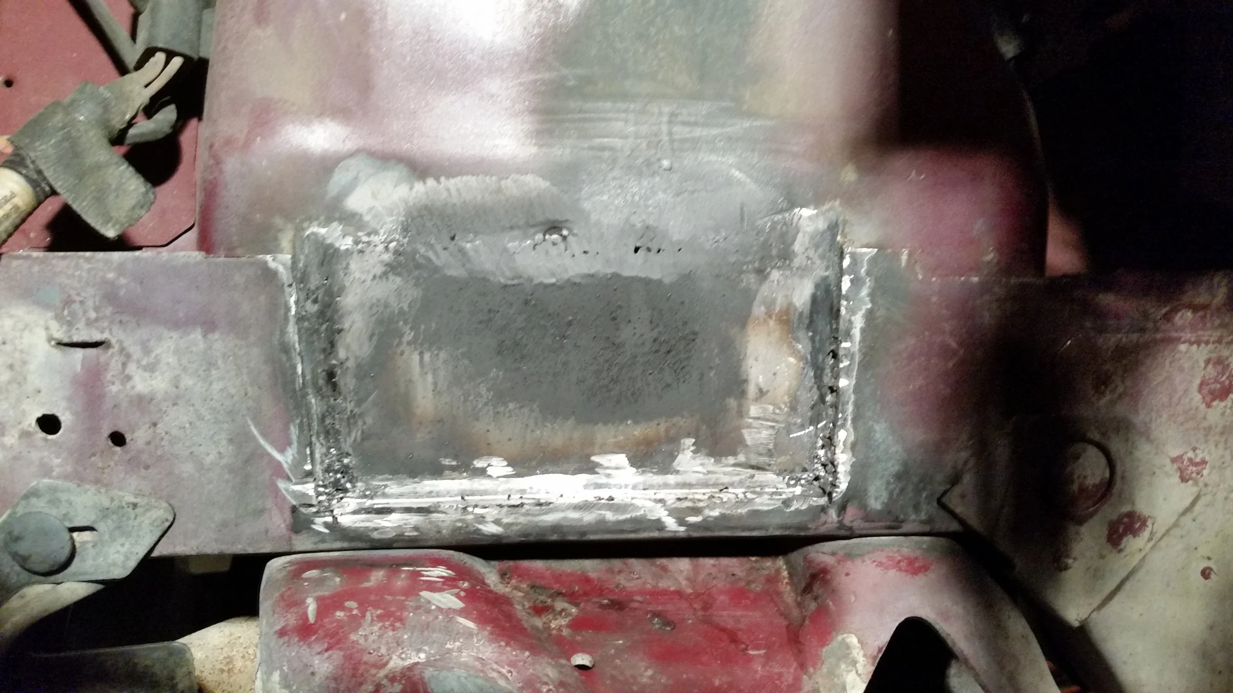

Almost done. Primered both sides of both plates, got them both welded in, and smeared PBA over the welds of the outside plate to fill in pin holes. Gonna let it set up over night, sand and paint it all tomorrow.

Good job so far.
