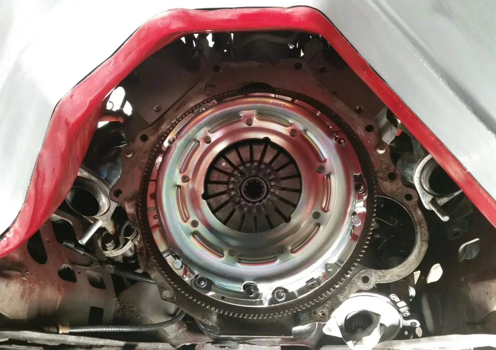

I took this afternoon off because it was supposed to be sunny and 55 degrees, which is basically T shirt and shorts weather for me right now. I had 4 hours to myself to get the transmission back in the car, and the exhaust hung. Guess how far I got?
Yup, the flywheel and clutch set up installed. It started off like anything I do. I got the flywheel on and torqued, and realized I forgot the engine plate. Off came the flywheel again.
Then when it came time to torque to the pressure plate bolts, I snugged them with loctite, and when I went to torque the first one to 25 ft lbs, it just spun. Fuggin stripped! Second one, same thing. I had flames coming out of my ears! Instead of pulling it all back off and throwing :poo: everywhere, I stopped and pondered. I was reusing the bolts that came with the engine, and they were 3/4 inch length with lock washers on them. I noticed they were maybe turning half way into the flywheel. I made a trip to home dept and get 1-1/4 inch versions, and boom, they torqued to 25 ft lbs with no problems thank the being that may or may not exist that shall remain nameless (see what I did there @CarMichael Angelo?)!!! I was gonna flip if I had to buy a new flywheel after just installing the friction surface(which cost $60 already). The 1-1/4" bolts barely peek out the backside of the flywheel.

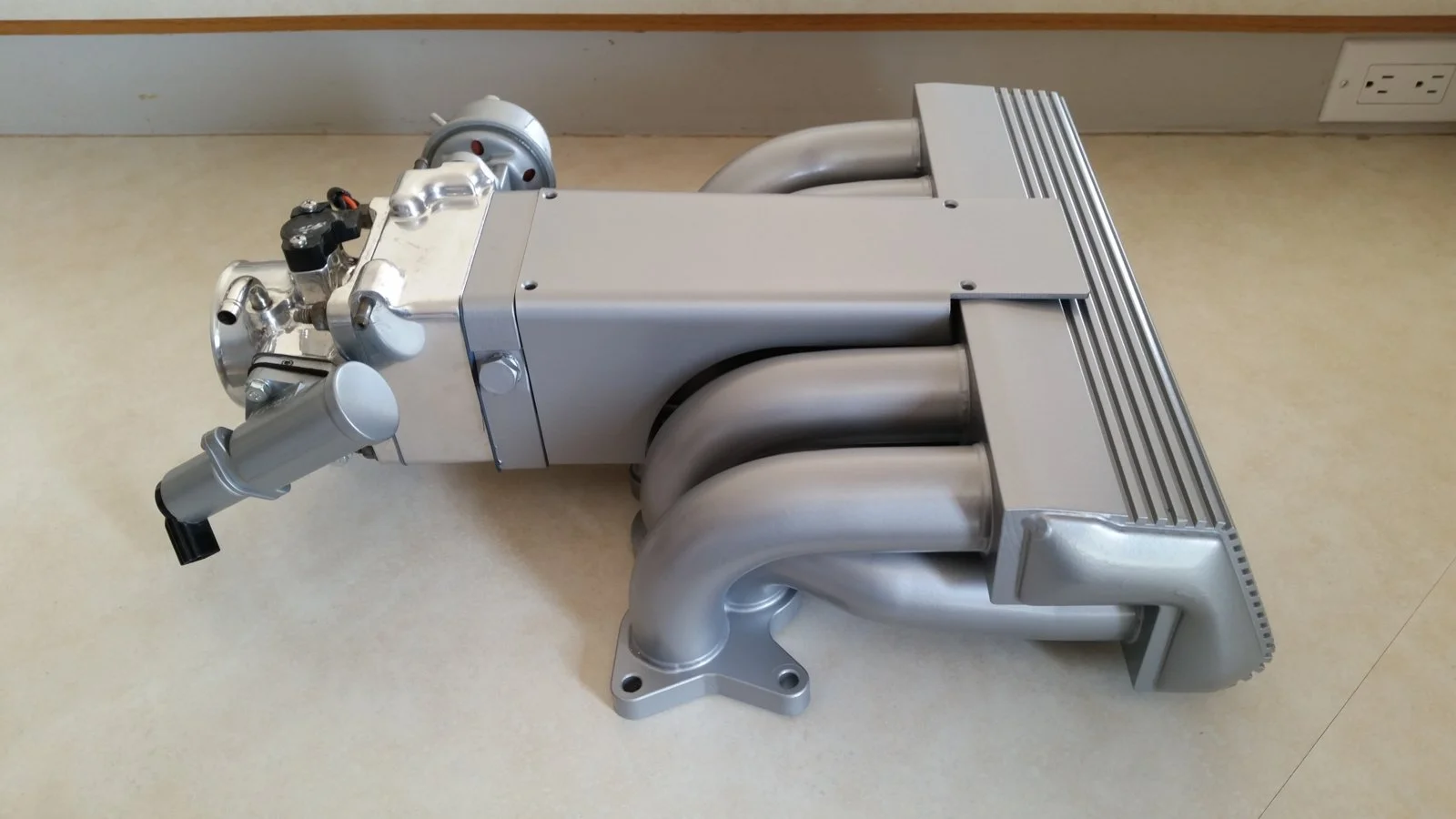

Lastly, the final cause for not getting as far along as I wanted. My ebay tubular intake cover showed up while I was under the car. I shifted focus to scuffing and painting it.
Its not a perfect fit, but pretty nice for a fraction of the cost of the OEM ones listed. Plus, Im not a huge fan of the 5.0 HO emblems that are on the OEM pieces. Its good enough for my not so perfect car. Thats all for today. Transmission install is next, hanging my newly welded up exhaust, and reinstalling the intake. Then I am going to have my custom tail pipes done up! Might be driving this bisch when Spring decides to actually be here for real.

The short bolts are what the PO of the engine had his pressure plate bolted on with when he sent it to me. Maybe he's the devil? Heck I dont know, but its done right now, just wasted my great afternoon on it.
Would you mind posting a link for that intake cover? I haven't been able to find it on ebay.

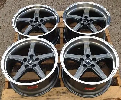

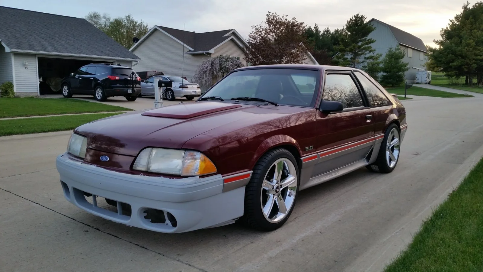

Stumbled on some wheels that struck a cord with me. In high school I had my red/silver GT on turbine wheels, while a friend of mine had a black GT on chrome Cobra Rs. I have always had a soft spot for Cobra Rs, as "played out" as they are. Now if you remember my engine colors, I have used a dark gray on my VC's, and will be using it in other areas as my accent color.
The 2010 GT wheels I bought just dont sit right for me. I really like the rear 18X10s, because they are concave, however the front wheels are so flat, they just seem odd.
All that being said, I have also always like wheels with a lip front and back. So, in you guys' opinion, am I on crack to scoop these up for cheap, toss a mustang center cap on them and run them? They are 18's, so my tires will swap over, and I think they match my color scheme well...
Should be able to sell my 2010 GT style for the same price as the knock off Cobra Rs locally.
I think the back wheels just need to be pushed out half an inch or so. They look to be a little more "tucked" than the fronts in the image.
The real issue is that the front wheels need an alignment. The camber is so far out of whack the tops of the tires point out. I was waiting until I replace the leaking steering rack, but that has been pushed down the priority list.
I have never liked the front wheels. They are not the same shape as my factory '11 GT wheels were. They are way more flat, where as the factory Ford wheels had some shape/curvature.

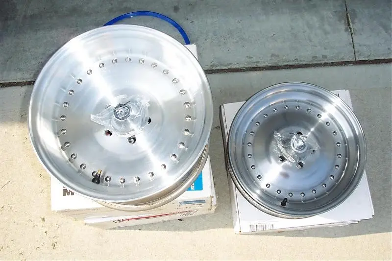

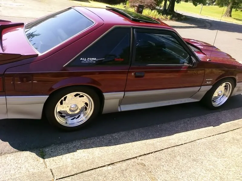

There was only one set of wheels that I truly lusted for, and was willing to pay my whole paycheck for to get. But that was a long, long time ago. Now, I wouldn't consider putting them on anything to include using them as a set of "roll along wheels" for a restoration in progress.
I was one of the first guys in Omaha to have a complete set of these things on a car in 1978, They were on the Thundercolt. mine even had the original centerline centercaps ( Just an orange C/L) Now they make me shudder to look at them on anything. Old wheels rarely stand the test of time. Nobody wants a Keystone Klassic or Craiger SS (and everybody had to have those things too) Centerline never made any wheel that has, and every car I will picture has a set of their billet wheels on them. They all look dated.
Reactions: A5literMan
Im with you on Centerlines looking dated, especially those that you had in '78.
For now I think I am going to spend $10 and plastidip my current wheels a metallic silver and see if that helps. I think part of my problem is the chrome makes them look like a blob of wheel, rather than showing any detail. My factory set that I loved were silver.
I had those wheels on my first brand new car, an '84 Z28. I loved them.
