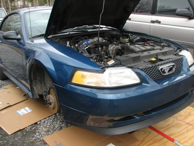

as she sits right now:
the beginning of the header install... and dont be jealous of my garage floor of the future :rlaugh:

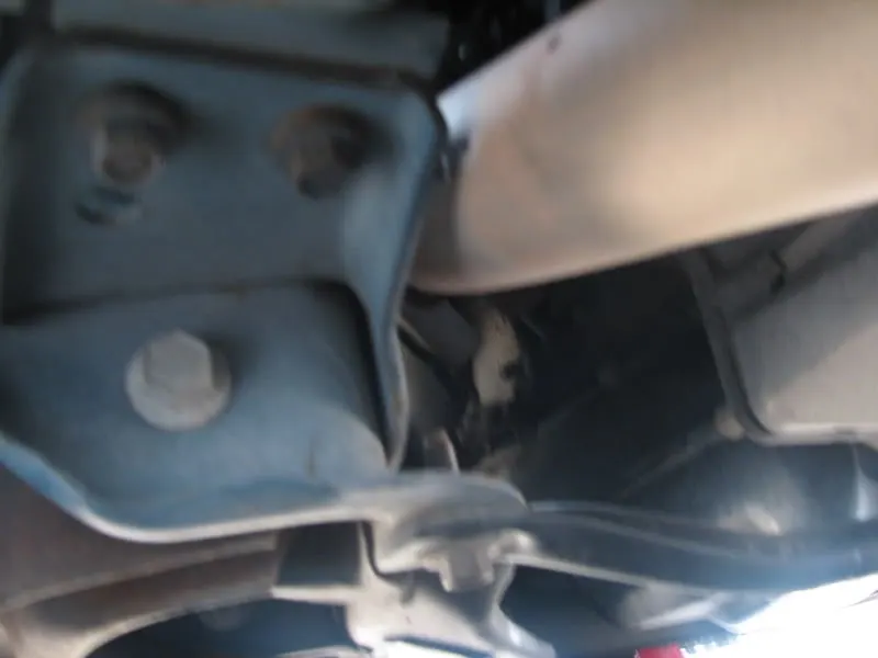

when i was pulling of the h pipe i noticed it had rubbed an area of the underbody...no damage just a couple little scratches..is this normal?
i didnt realize those pics were blurry until now but it gives you an idea of where and what it has rubbed on..
i think i may have bit off more than i can chew with this header install since i cant raise the motor or drop the k member.. i have a buddy that will hopefully be helping me out.. now i have to install the new brakes before i get into the header install... what a PITA :nonono:
I also started cleaning wheel wells while i was out there.. dummy me i forgot to take before pics so right now all i have is a few after pics.. when i start on the other side then ill post some before shots lol
they arent 100% clean but it was like 48* out and dropping and getting ready to snow so this was as far as i got.. i noticed on the insides of the wheels there were paint chips but when the wheel was back on you couldn't tell they were there.
