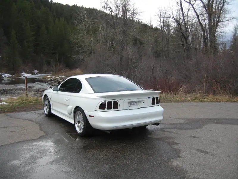

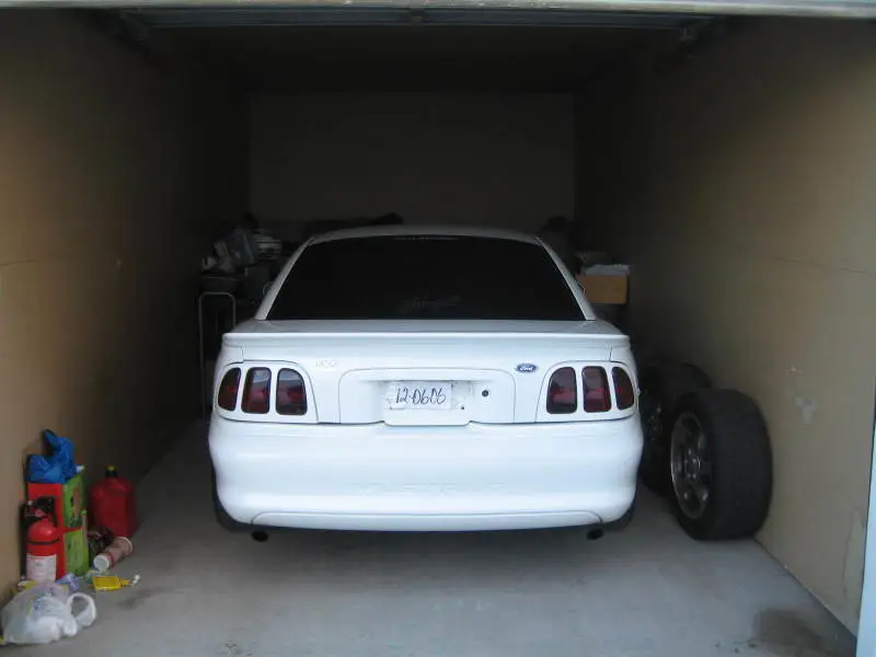

Anyhow, about 3 coats here.. looks pretty dark because it's white..
