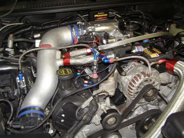

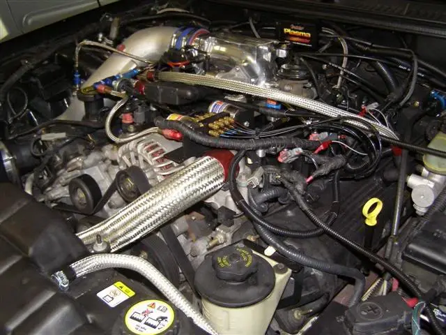

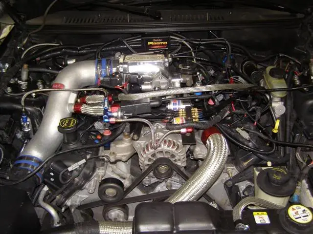

I installed my own, including the Wideband, gauges (AFR and FP), and the nitrous kit (with window switch, electronic WOT switch, all the plumbing, etc). This way, if something goes wrong, I know how it all works and how it's all wired and plumbed. Plus, I can do a much cleaner install myself by taking my time and carefully hide all the wiring. Note my pics below - even with the Plasma Booster in the mix, you still hardly see ANY loose wires. If you have basic mechanical skills and can follow directions, you'll have no problem installing this stuff yourself...no special tools required.

Clean install and that c&l inlet pipe looks huge
My install could be much more "hidden" though I was pretty anxious during the install so just mouted the solenoid there for the time being. Haven't been bothered enough to go and relocate it yet
