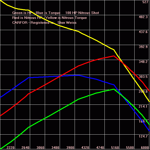

Computer simualtion of 260 HP 4.6l with 100 shot
Stan
