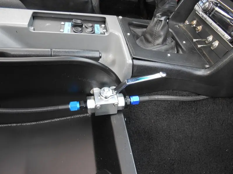

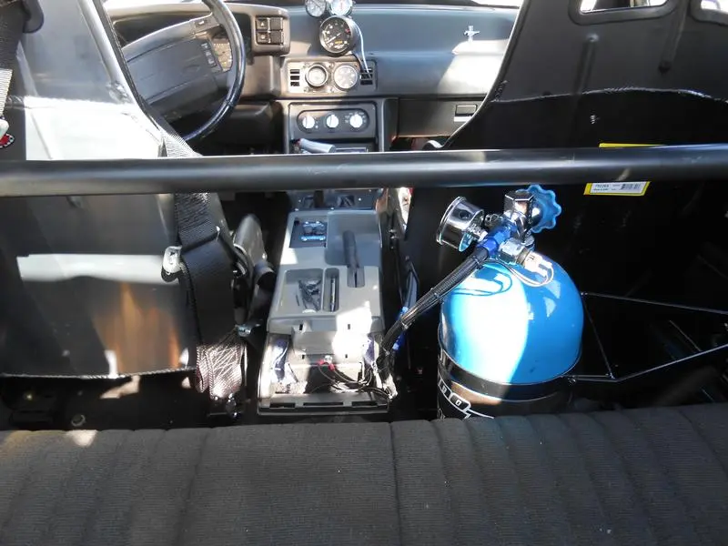

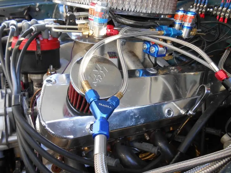

The first update to the system, -6/-4/-4 Y in place of the -4/-4/-4 T. 6 Foot length of -6 feed line
to a Nitrous Outlet,1/4 turn shutoff.

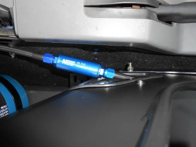

a 8'' -6 to NOS high flow filter.
Another 18'' line to a -6 dual port adapter and -6 bottle nut.
New jetting was .047n/.038f 1st and .048n/.040f 2nd pulling 7*
no delay on the 1st kit,90 % 1/10 second on the 2nd

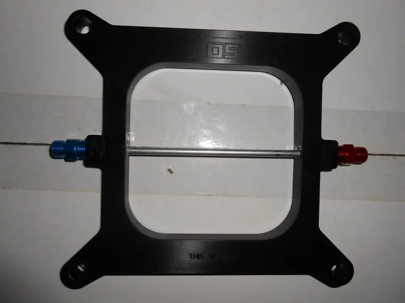

When we get closer to spring,i will be giving this plate a try.
NOS Big shot,68 hole stainless.
