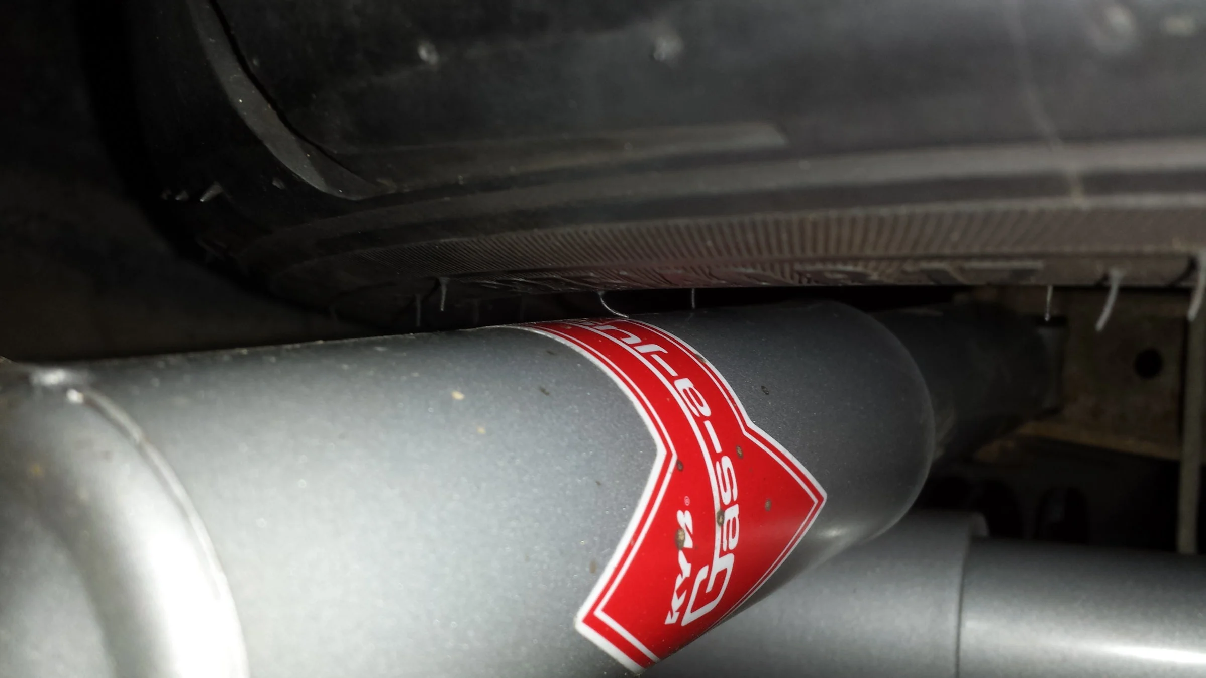

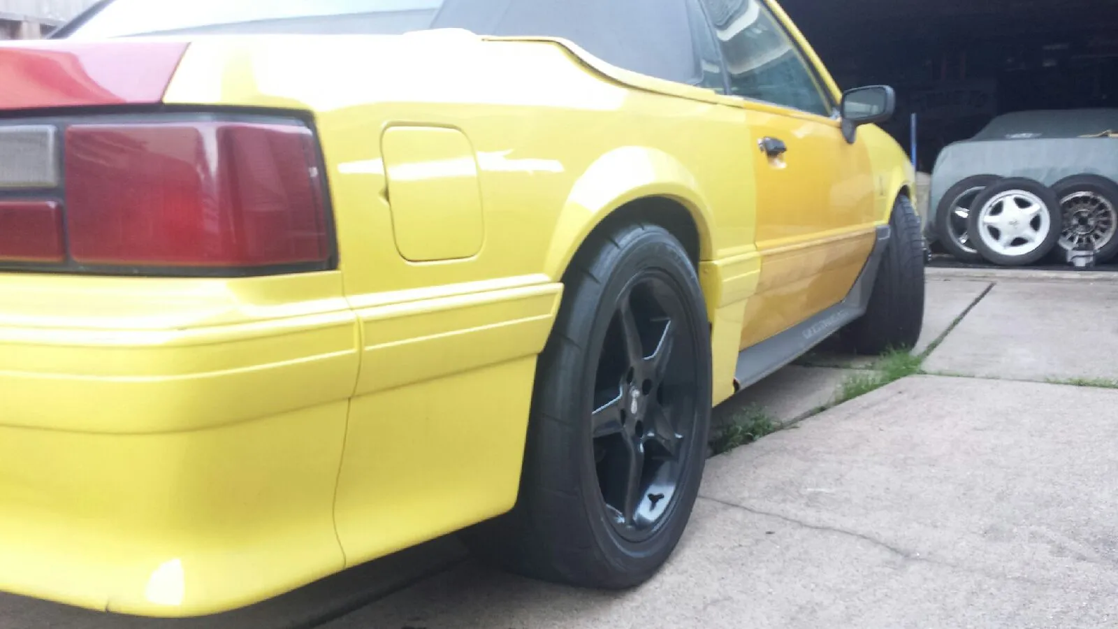

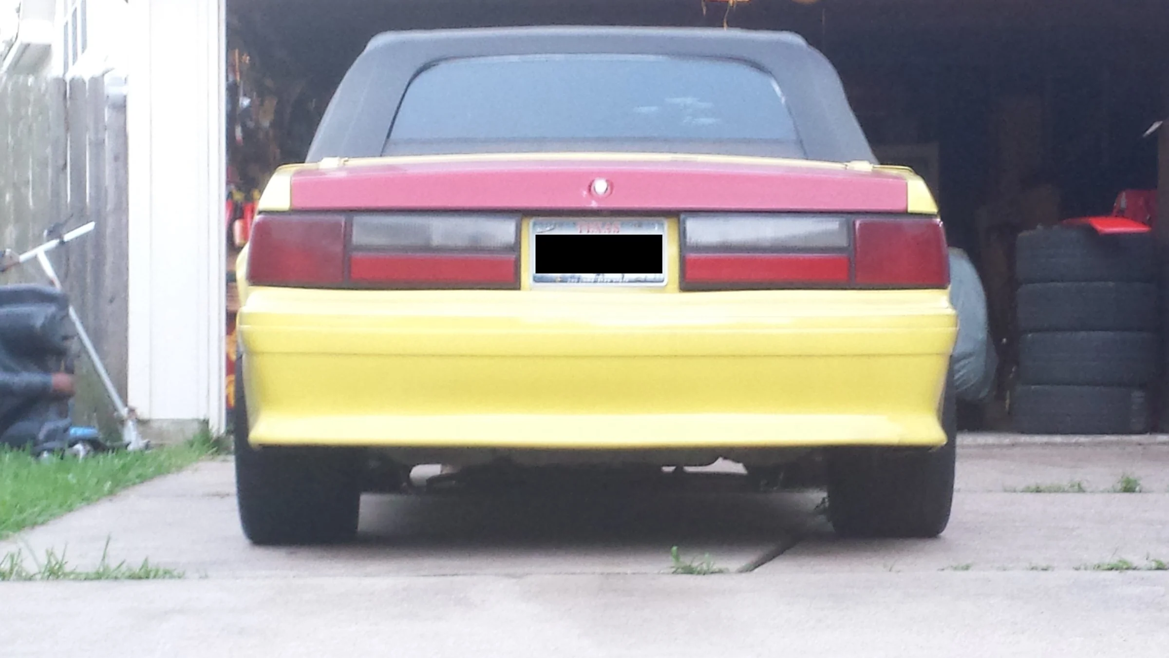

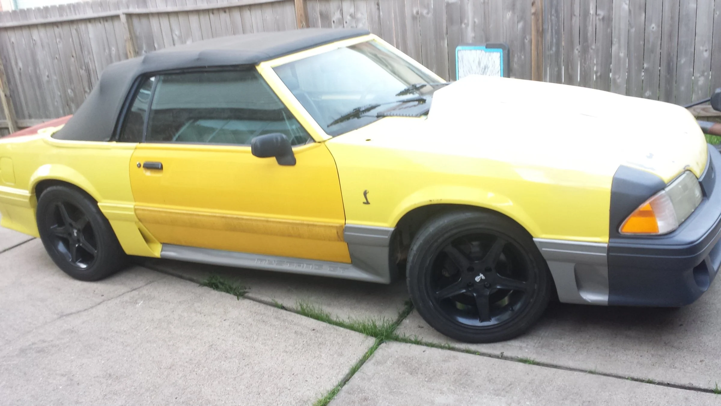

if this helps i just put on some NT05R on some 17x9 cobras with 275/40/17 everything is still oem quad shocks and all
nothing rolled but i did need to use a small spacer if i remember they are 1/4" not very thick at all
front are 17x8 with 245/45/17
with quads, aftermarket control arms, fenders are not rolled
