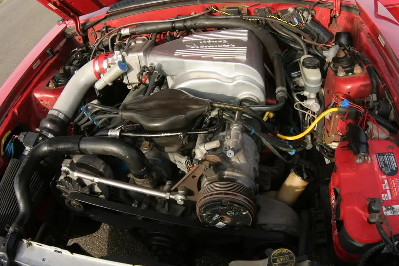

i dont remember the exact number at all, when i pulled the S/C off, i didnt have the right size belt, and i wanted to drive it home the same day, i went through about 4 belts.. buying them trying them and takeing them back.. when i got close to what i needed i used (pictured) that chrome rod to push my alt; further away to apply tention, until i either take the A/c off or but the Right Size belt..

If you didn't use a a/c delete kit of some form, you will not find a belt that doesn't rub. Look into the ford racing a/c delete kit as it relocates the power steering pump to compensate.
The smog pump however can be removed with no ill effects.
