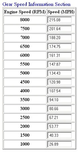

Here is your chart based on 275x40x17, 1:1 (3rd gear c4) and 3.80 rear.
