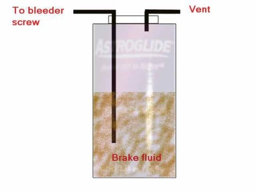

That's what I thought too while chasing a low pedal on my car after changing the master. After hours of swearing I cracked open the bleeders, gravity bled an entire container through it then fabricated a home-made bleeder on the spot, and I cured it. The time it takes you to tighten the screw and yelling "pump" to your assistant, the air bubble has already gone back up.
Anyone can make one of these. A real time saver!
