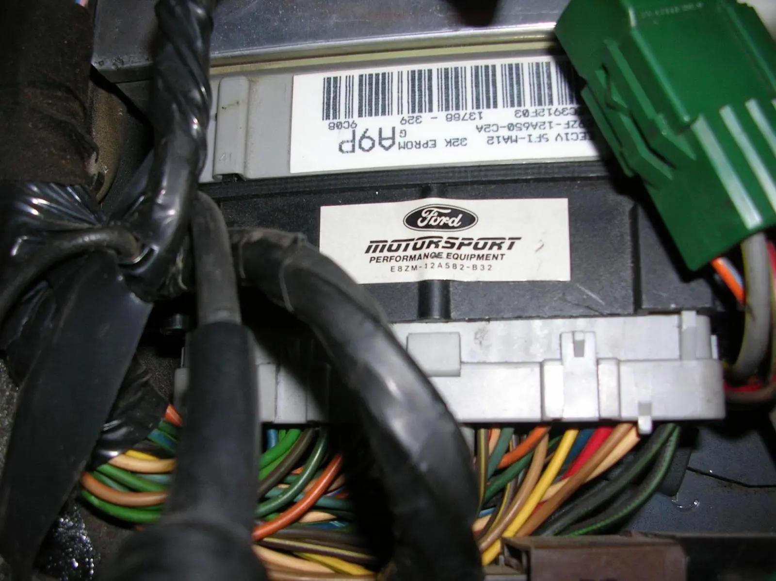

Computer: If you got this far and everything else checked out good, the computer is suspect.
Remove the test jumper from the ECC test connector located under the hood.
Probe computer pin 22 with a safety pin and ground it to chassis. Make sure the computer
and everything else is connected. Turn the ignition switch to the Run position and observe
the fuel pressure. The pump should run at full pressure.
If it doesn't, the wiring between pin 22 on the computer and the fuel pump relay is bad.
If it does run at full pressure, the computer may have failed.

Prior to replacing the computer, check the computer power ground. The computer has its own
dedicated power ground that comes off the ground pigtail on the battery ground wire. Due to
it's proximity to the battery, it may become corroded by acid fumes from the battery. It is a
black cylinder about 2 1/2" long by 1" diameter with a black/lt green wire. You'll find it up
next to the starter solenoid where the wire goes into the wiring harness
If all of the checks have worked OK to this point, then the computer is bad. The
computers are very reliable and not prone to failure unless there has been
significant electrical trauma to the car. Things like lightning strikes and putting
the battery in backwards or connecting jumper cables backwards are about the
only thing that kills the computer.

Thanks so much for the replies. I have since figured out that it's my harness adapter that's the issue. I tried 2 computers and neither started the car (same fuel pump issue with both) - then I put the old speed density computer back on without the harness adapter and it started up first shot - pump turned on no problem. So that's obviously the issue. Maybe I'm missing a step with this harness. If anyone has any advise, i'd really apprecaite it.
Thanks!
Curtis
I figured out the fuel pump issue. It was a bent prong in the harness - so that's all fixed. Now the issue is I finally have it idling where it should be - or close to it, but my car is now dumping fuel so much now that it's coming out of the exhaust. Is this a timing issue, or is something wrong with the ECU? Any help would be appreciated. Don't want to ruin my motor. It was running nice before I did the conversion.
