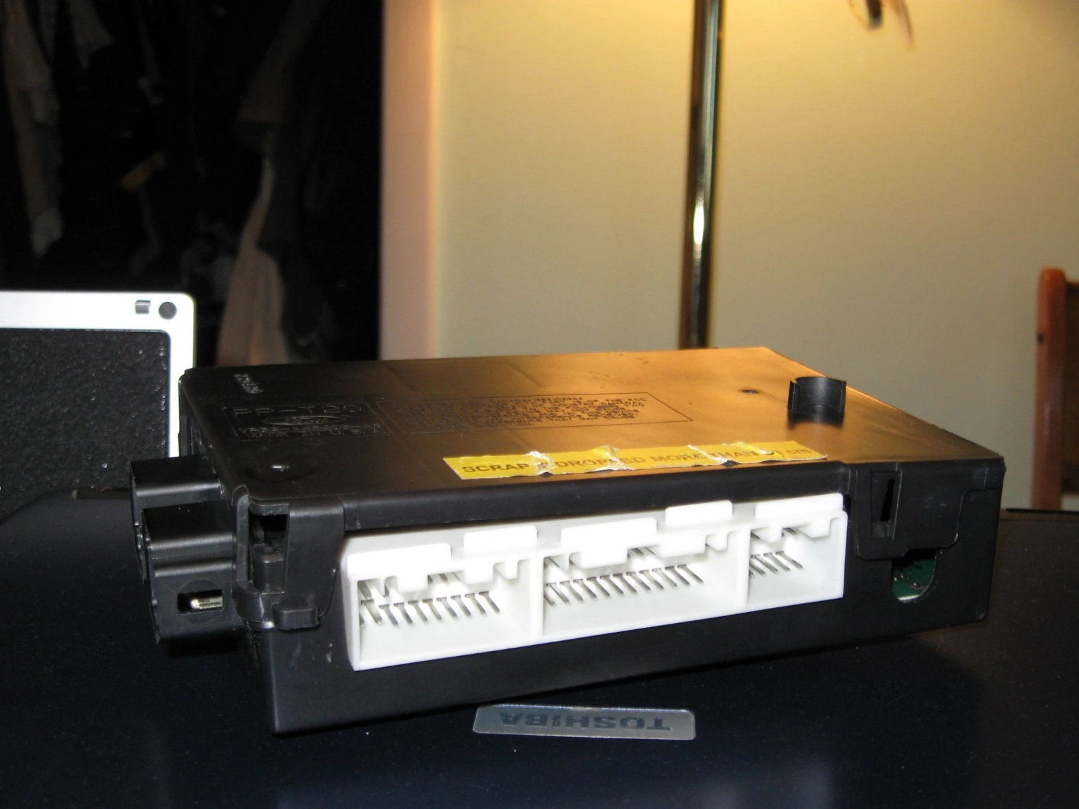

The interior lights are controlled by the GEM. Guess where the GEM is grounded? Behind the center console at the same location the radio is. IMO, the center console is a great place to start looking.

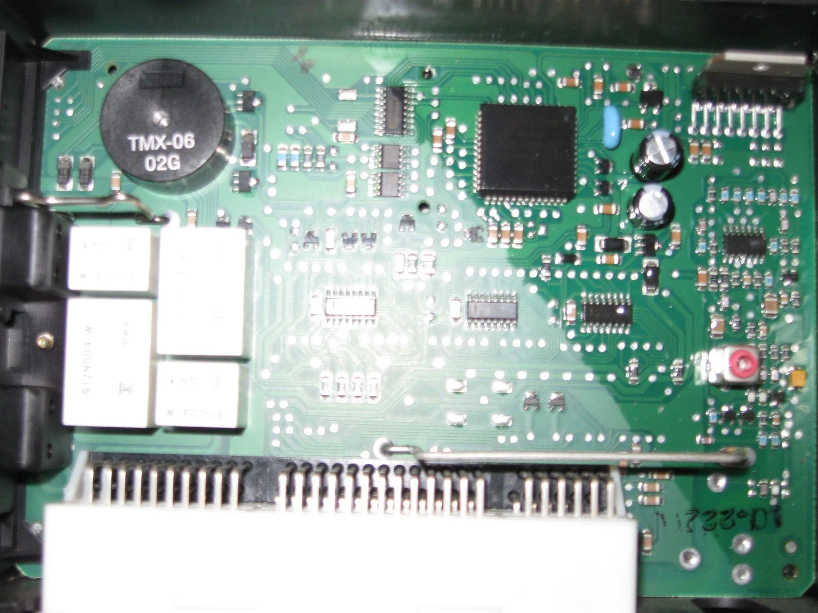

Here is a pic of the GEM ( a black box, truly), and its innards. Really, since all the components are soldered directly to the circuit board, any mods/fixes would be difficult. Looks like a timer of some sort, and a CPU/PROM/FPGA device plus a few memory chips and support circuitry.
