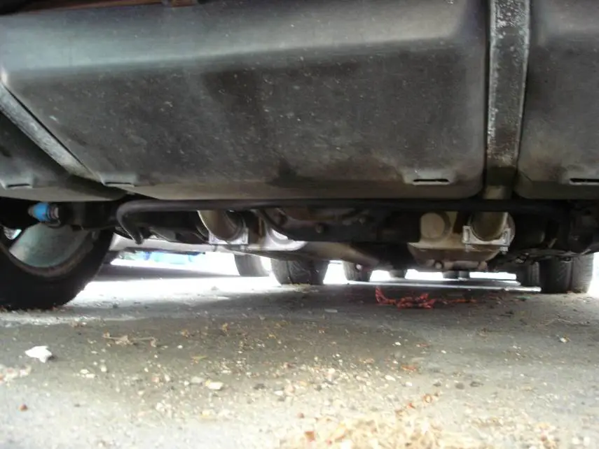

PS. i have flowmaster cat-backs on both my cars and live in New England. One is 4 years old the other is 2 years old and both are still rust-free. Here's a shot of my 4-year old cat-back
I agree, flowmaster quality is crap, not much if any better than mac. And i run a flowmaster catback. I've had 2 catback rust out, got the third for free, so....
