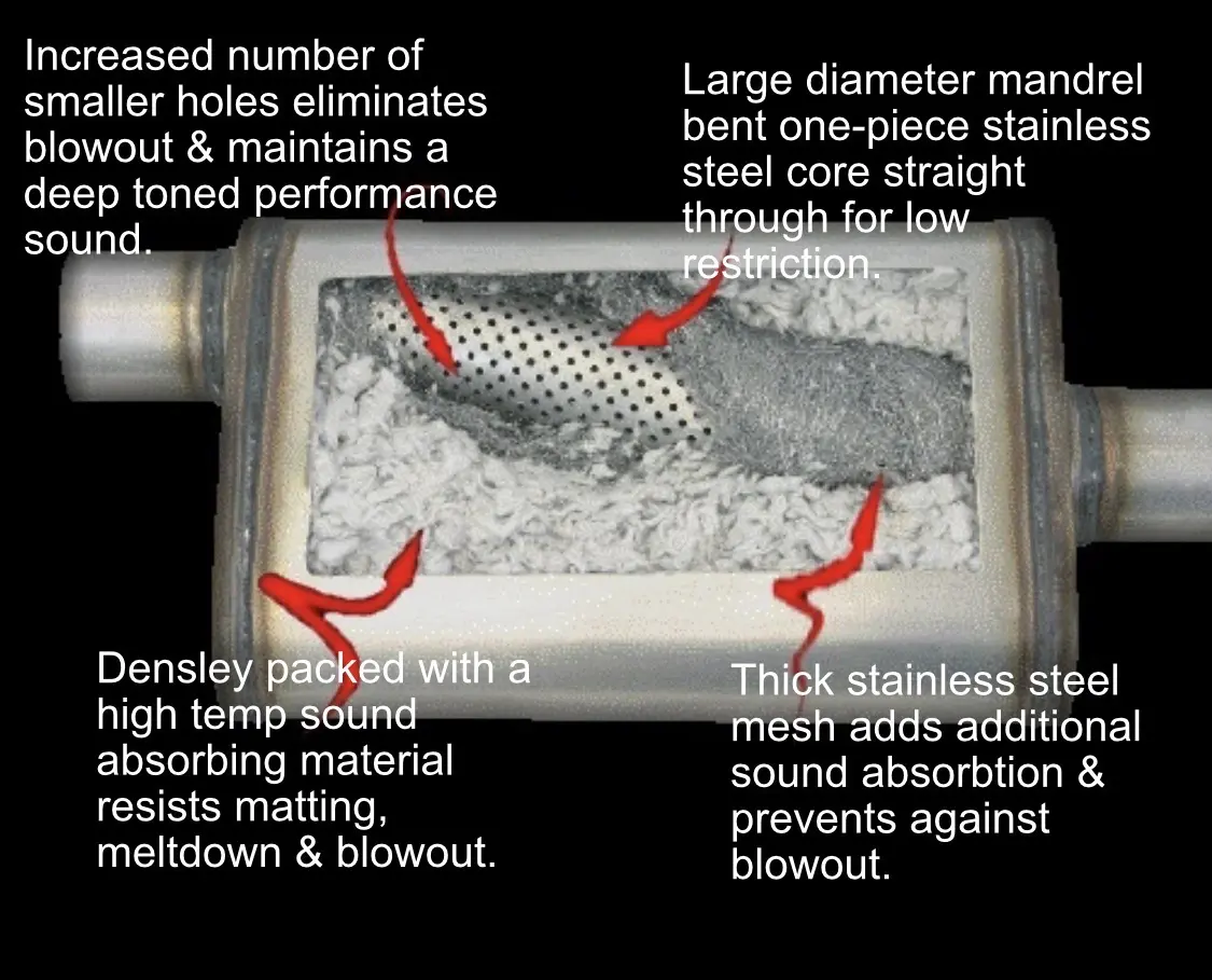

94 convertible with no performance upgrades . I always liked the flowmaster 40s sound . My new car has the 4 cats and some Flo pro max mufflers on it . I am thinking of cutting off back cats and keeping the H and the Flo pros on it to bring up the sounds a bit . Would this be better than putting on 40s and also cutting off the back cats ?
