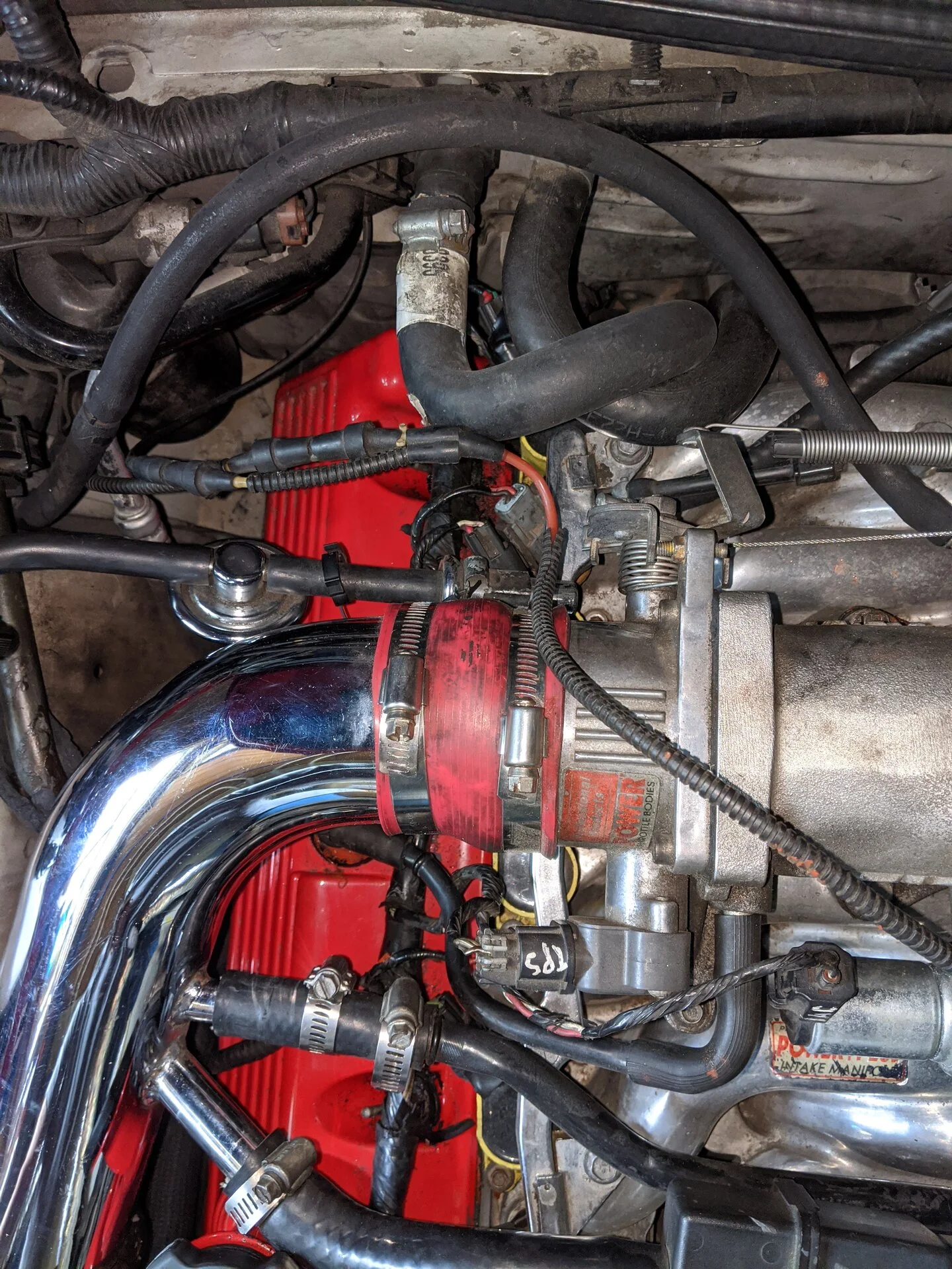

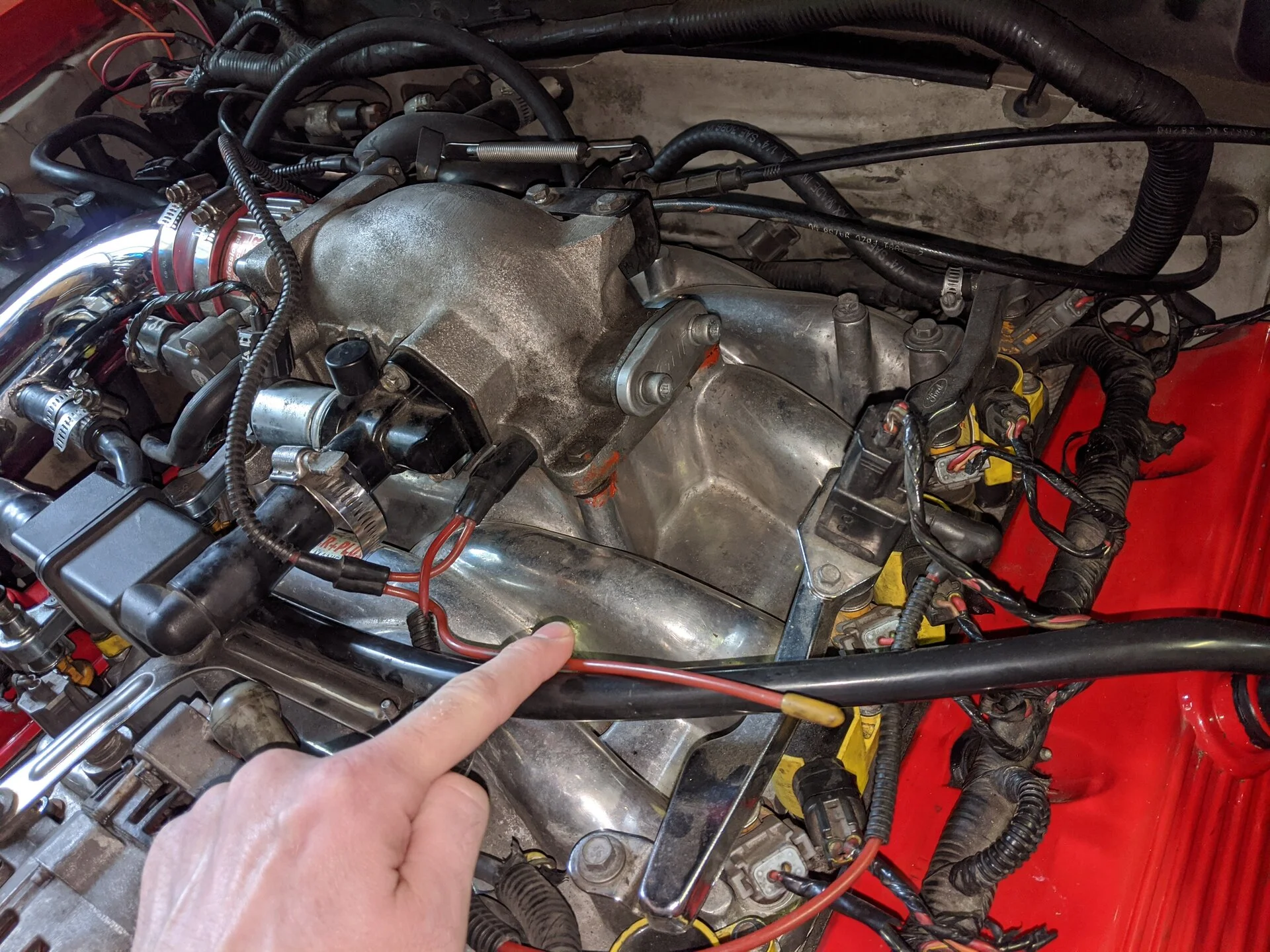

As it turns out, this car has had an EGR delete so no EGR valve, no solenoid. I Inspected the lines coming from the area but couldn't discern anything obviously damaged or anything. I am still not 100% sure of any vacuum leaks or not though. The lines that would normally go to the EGR are of course rerouted now - one is capped off and the other looks to be going in to the fuel rail/injector sensors. I attached some photos

Okay so PCV valve seemed pretty loose and someone had sprayed some sort of goop on it (sealant of some kind). I put electrical tape around it and plugged it back in for a more snug fit. Car runs a little better and now has some power steering so that is cool. Still must have a vacuum leak somewhere though. Found a brittle fuel line that leaked when I pushed it so will be replacing that too

So far all sensors seem to be in place so unless one is just bad I'm pretty stumped at this point. Since there is no EGR anymore that seems to be out of the equation and the throttle body, transmission and exhaust sensors all seem to be in place. There has to be another vacuum leak that I am missing. But I don't know how to find it. I know you can spray carb cleaner on a running engine near the hoses but even on a cold engine that just seems like asking for trouble.

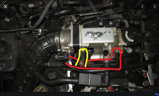

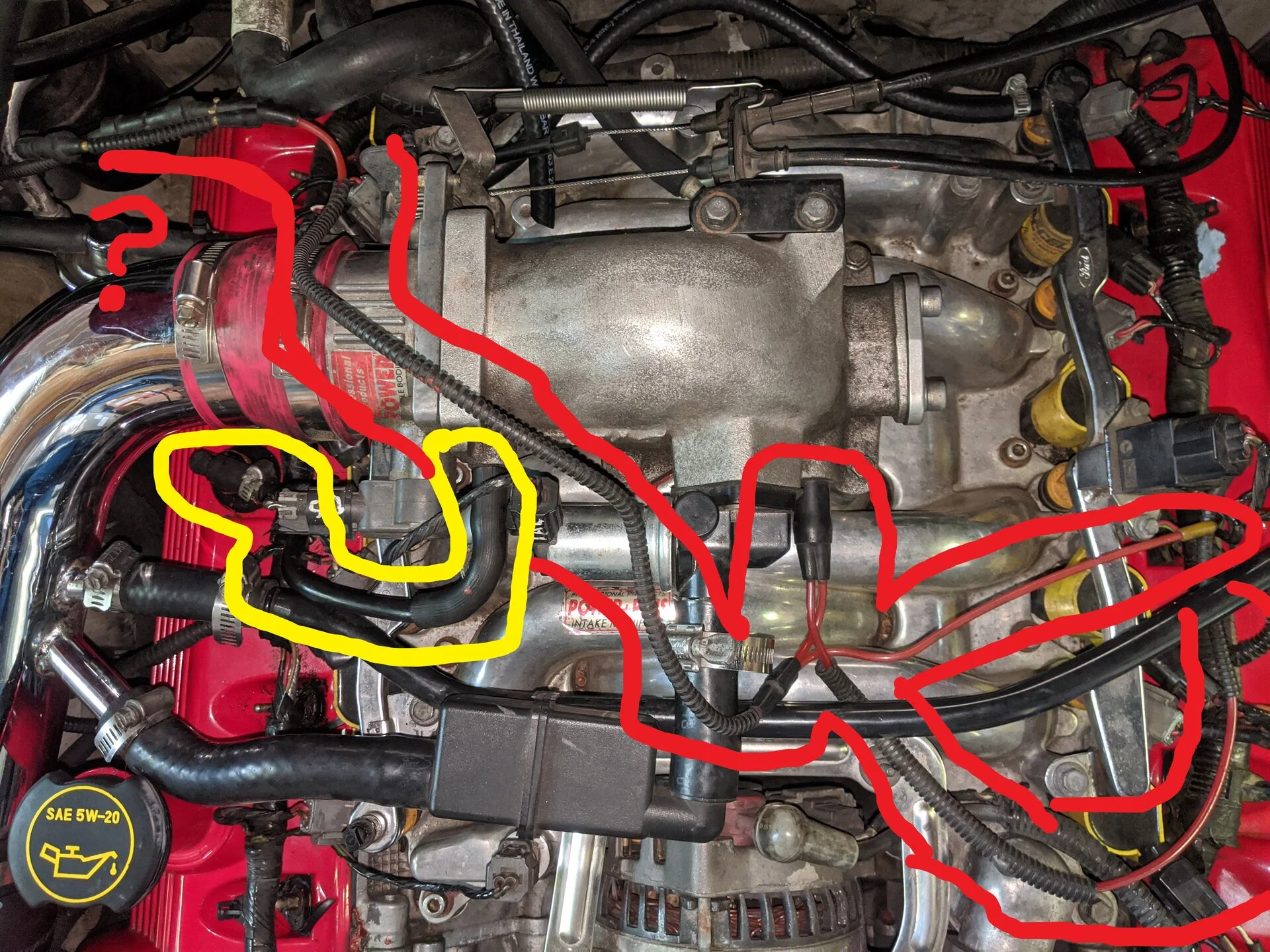

Okay guys. I've been staring at this thing for a while and something keeps looking funny. The first nice and clean image is a stock image from the internet of the 4.6l engine showing the throttle body . The second image is my car with the aftermarket throttle body and EGR delete and other things. Is it just me or is the PCV hose connected to the wrong side of the throttle body? Sorry for the crappy drawing illustrations. :( Maybe the aftermarket one is supposed to be flipped like that? Seems unlikely. I guess my concern at this point is if I swap them to find out what other damage might it do.
