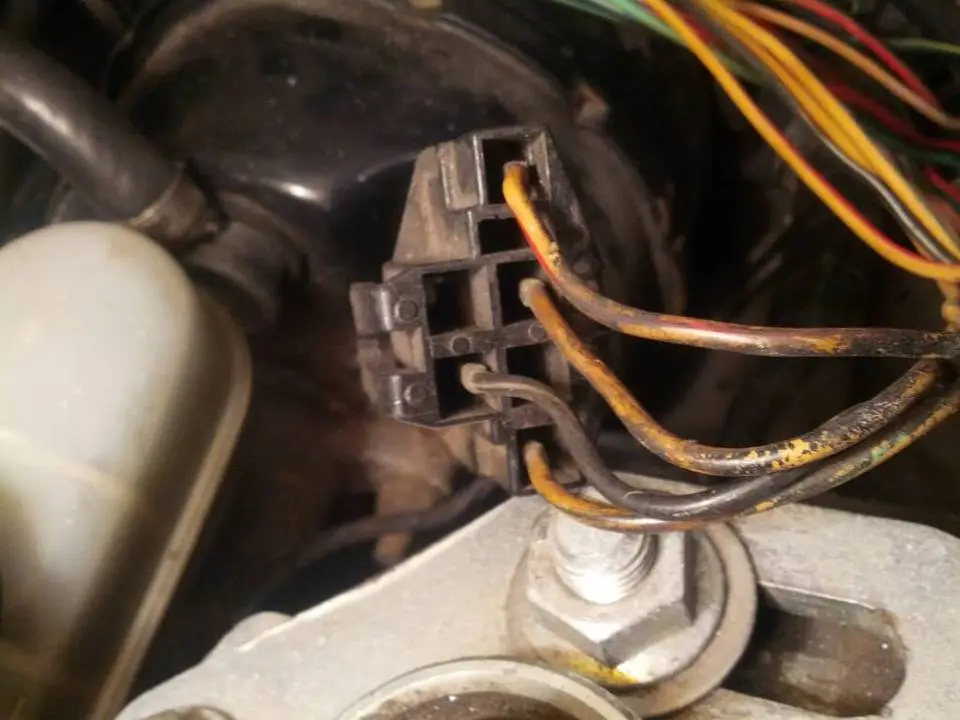

I noticed that I do not get a check engine light at all. I need to check to see if maybe the previous owner removed the bulb as all the non essentaild have been removed. Also, went to run for codes and found no sti connector. Traced the main wiring harness and found that it doesnt match up to the one posted by tmoss. My test connector has four wires goin in to it and his diagram shows three. There are no breaks in the wiring anywhere. Is there another method of pulling codes by chance? I do have the digital code reader but cant hookup the sti connector. Any input?
Three wires is the correct number according to what I know. The STI Input is a gray connector with a white/red wire. After many years, the white/red wire may be more of a gray color.

attachment.php
The STI has a gray connector shell and a white/red wire. It comes from the same bundle of wires as the self test connector.

Also, I cannot locate the test sig return wire to check for codes. My test connector has four wires to it not three as shown in the above linked diagrams for an 89. Heres a pic. Wire colors are black, orange/green stripe, orange, and orange/red stripe. Im stumped :mad:
Use an ohmmeter to test for continuity between pin 48 on the computer wiring harness connector and the orange/red wire. If you find less than 5 ohms, that is likely to be the STI wire stuck into the wrong connector.

welp, It's alive! I traced the extra wire connected to the eec test connector and it ended up being the sti wire. Previous owner must've stuck it in there. Pulled the codes and got some emissions codes do to missing items, as well as act sensor. Pulled the act sensor off and it was coated with gas. Cleaned it and reinstalled. Started up. Rich as hell. The fp was set at 39, but was now getting 60 with the new injectors in. Dropped it back to 39, and was finally able to hold an idle for me to set timint to 10 btdc. Ordered a Moates Quarterhorse with a custom tune by Willie at DirtyDirty Racing. Did an oil change to get rid of the gas soaked oil, and tightened up some hot pipe fittings. Lets hope Willie's tuuneis spot on!
