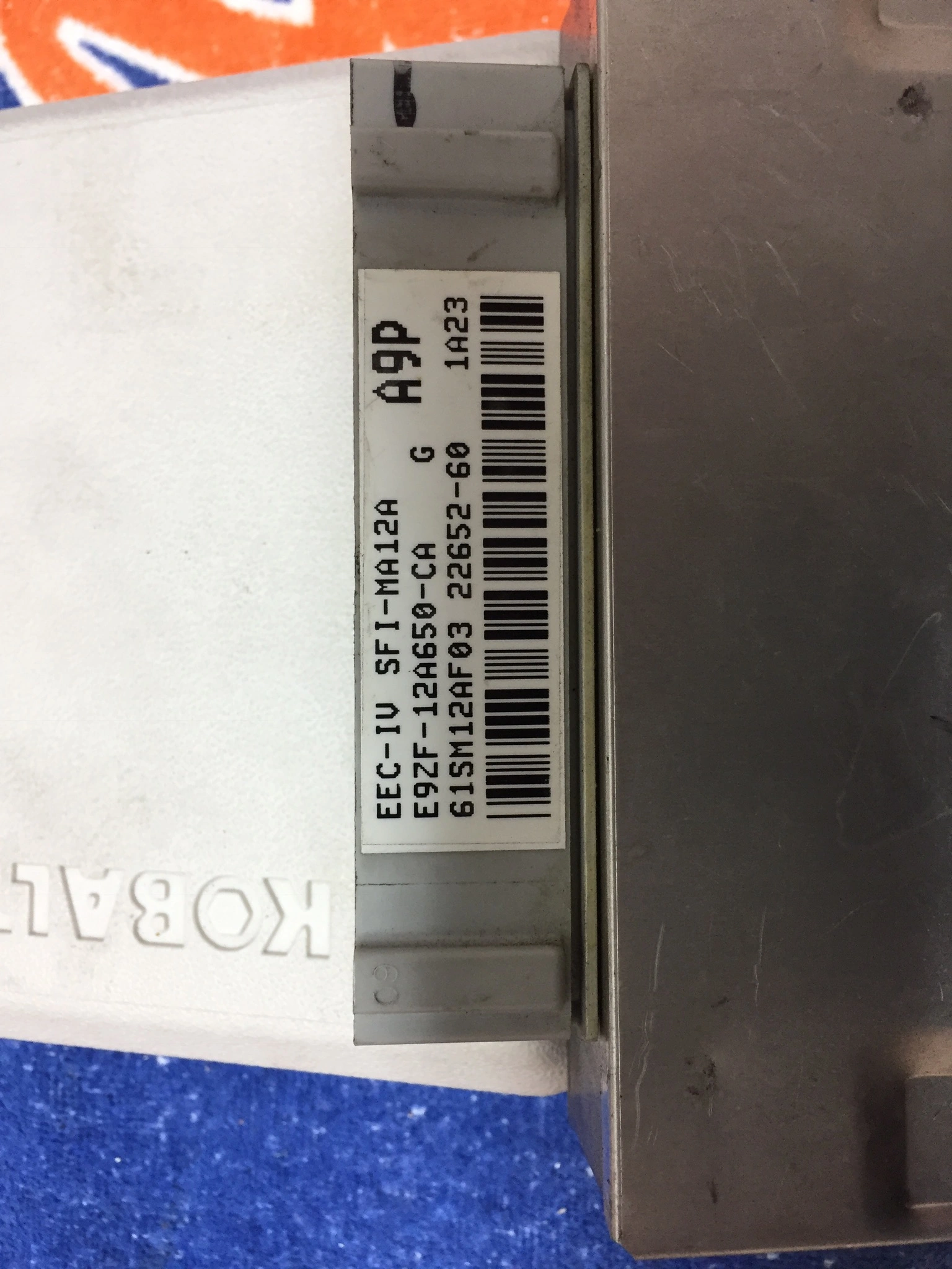

Thanks, Karthief. Here is a picture of the computer from the car. I took it apart and noted no burned smell nor obious, to me, shorted areas. I did notice that one of the three blue capacitors was drippy wet. The others were sticky but not wet to the touch. With the top cover removed and the pins at the top, the wet capacitor was the one on the left side. Do you think this could be causing my problems? I am sure it needs to be fixed, regardless. Anyone to recommend?
Thanks for all your help.

Liquid leakage or bulging tops on electrolytic capacitors is a sign that they have failed.
There are vendors on ebay that repair your computer for a flat fee. Unless you have steady hands, sharp eyes and some solid electronic experience doing component level repair, I would suggest that you find one of these vendors that has a good rating and use their services.
