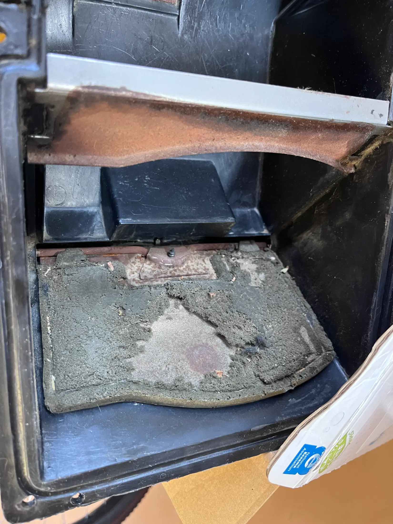

I’ve had to take that assembly out to reseal and clean it up. There is a door/flap in it that open closes. Removing and replacing the hvac box/assembly isn’t “easy” but definitely not hard to do.
I documented my experience in my progress thread “Komos 1990 GT” somewhere in there.

Was this it?
Progress Thread Post in thread 'Komo's 1990 GT - Parts Gathering Purgatory & Home Remodel'
Mar 24, 2025

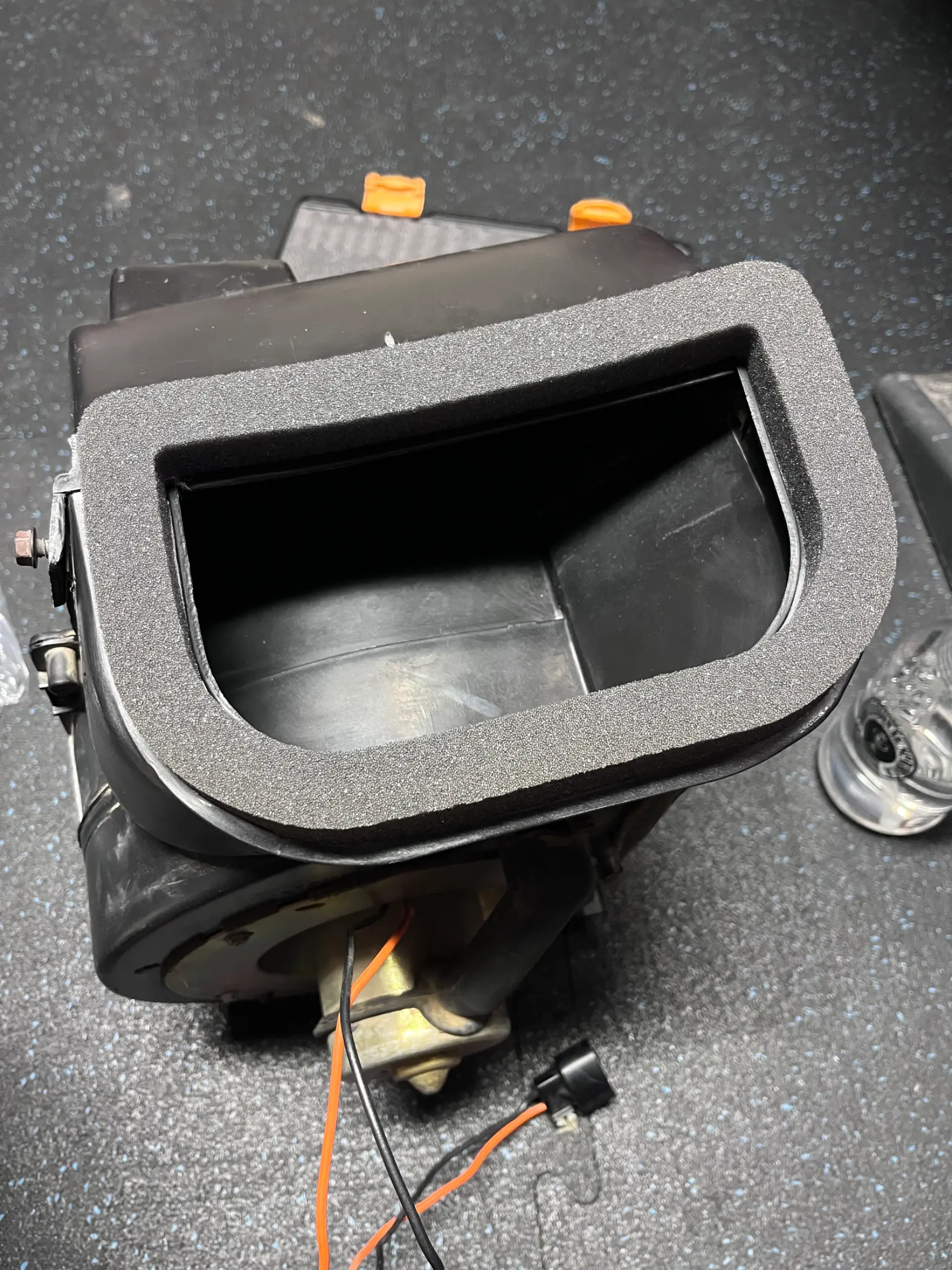

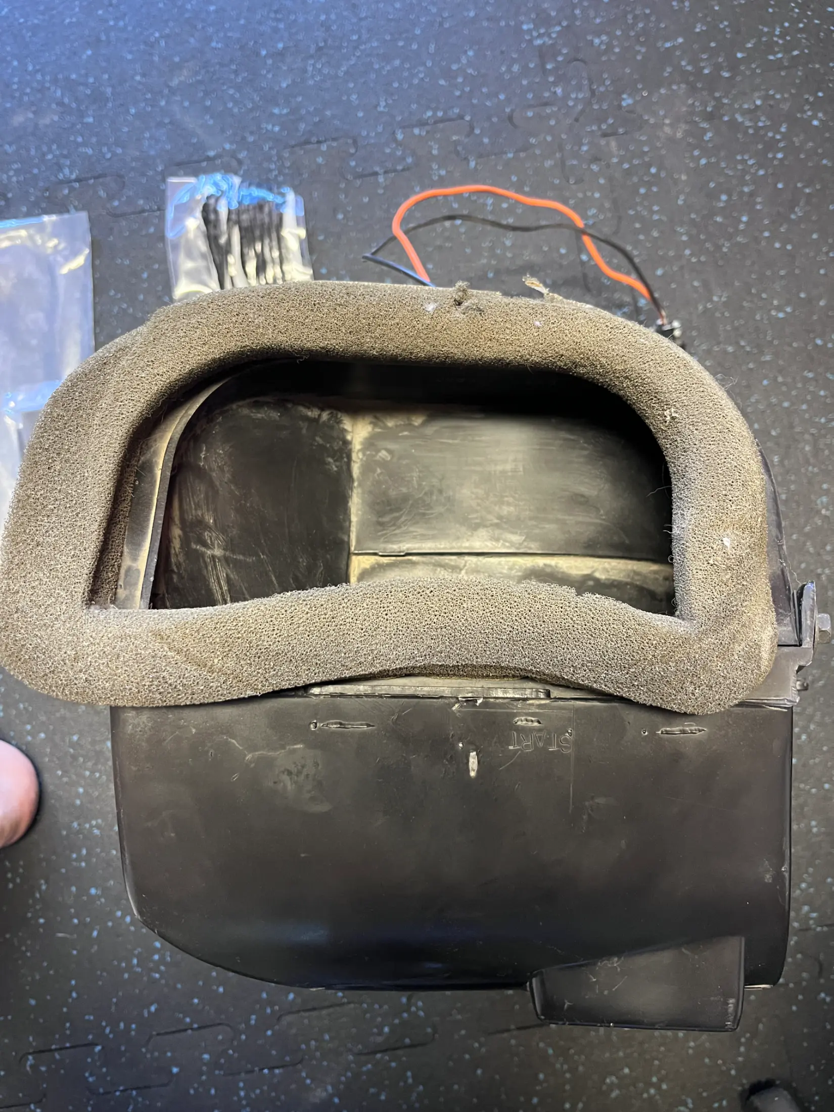

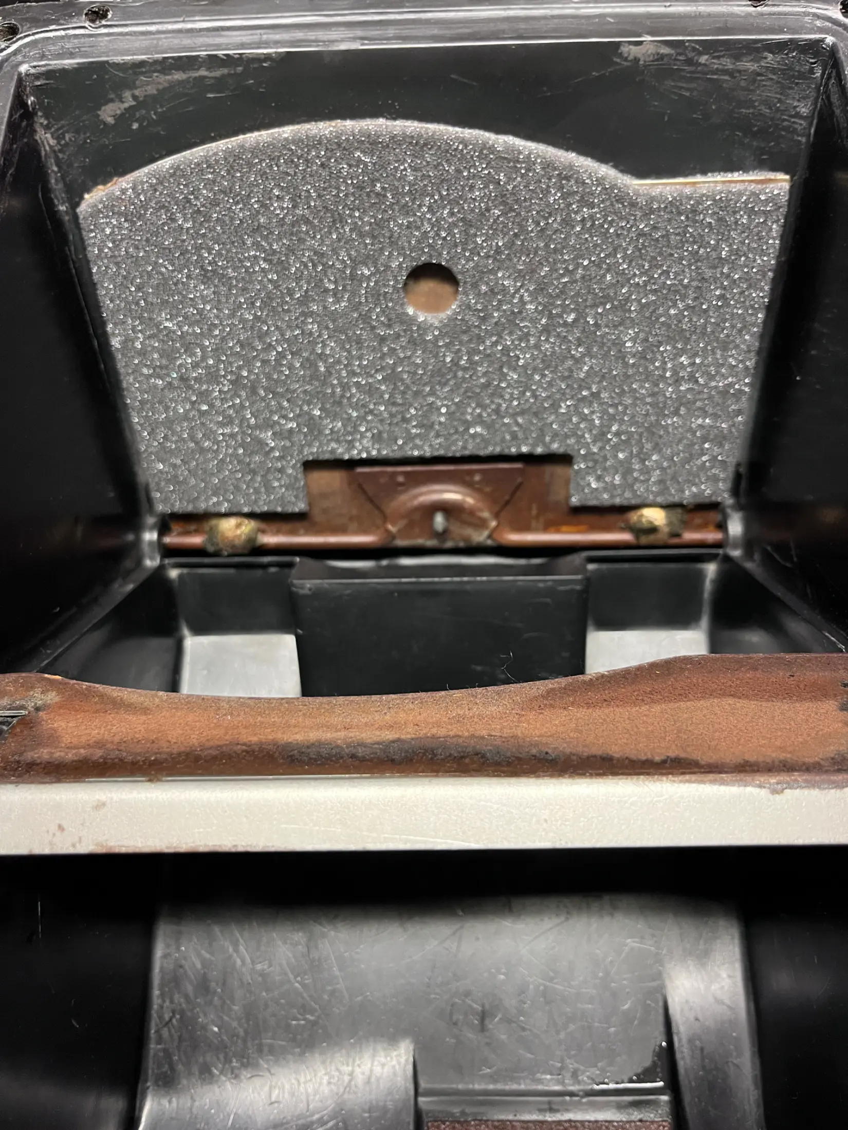

Got the blower motor all cleaned up and back together with new seals:
Old:
Mid cleaning (getting the adhesive off this flap was a pain):
New:
One thing I did not like about the LMR kit was the butyl strips were completely stuck to the package they come in… basically had to just rip chunks off then ‘roll’ them into the right shape and place them in the channel.
Old:
New:
  • gkomo
Yes thank you for going back and finding it.
I think this is what he’s talking about
