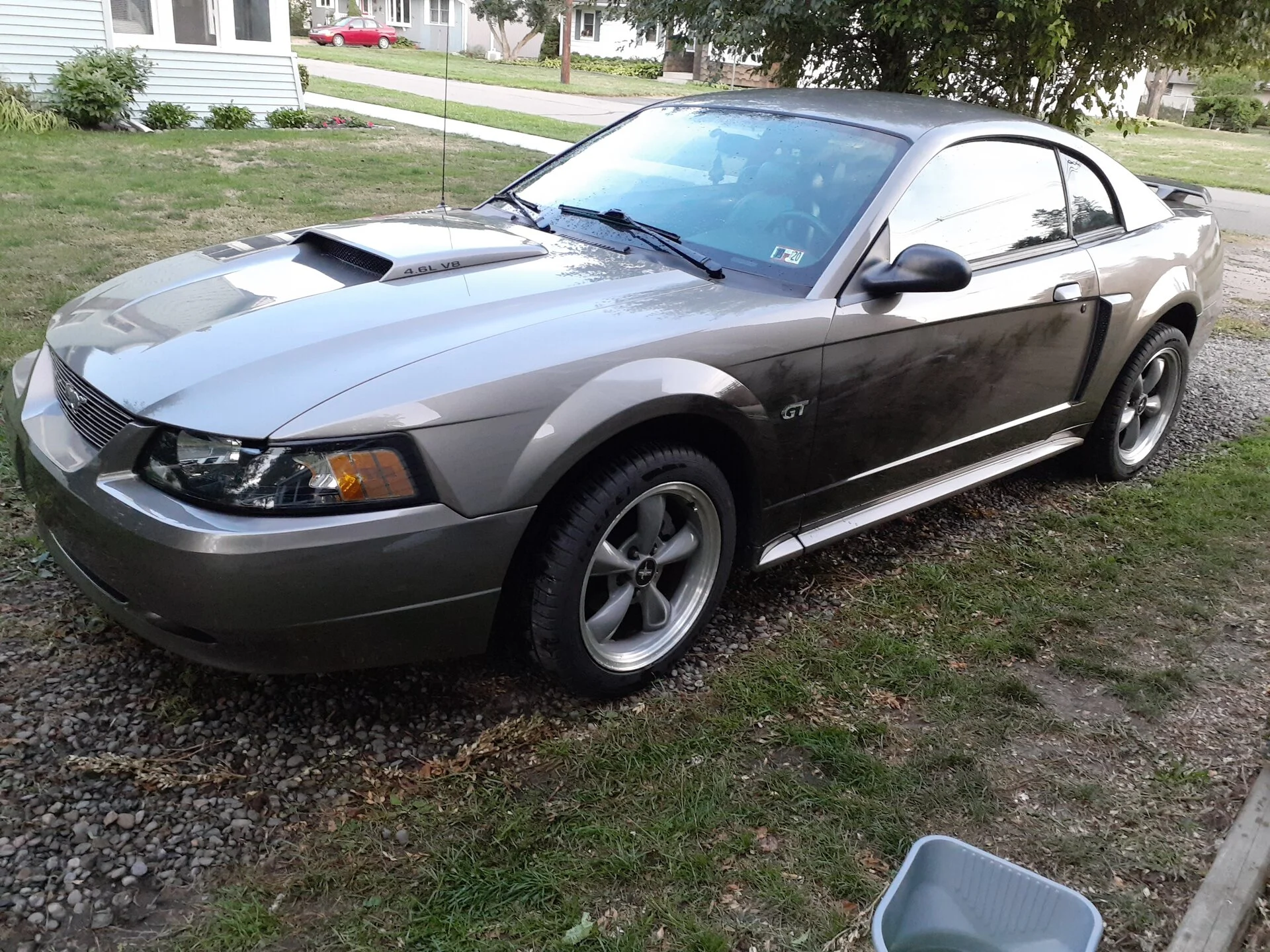

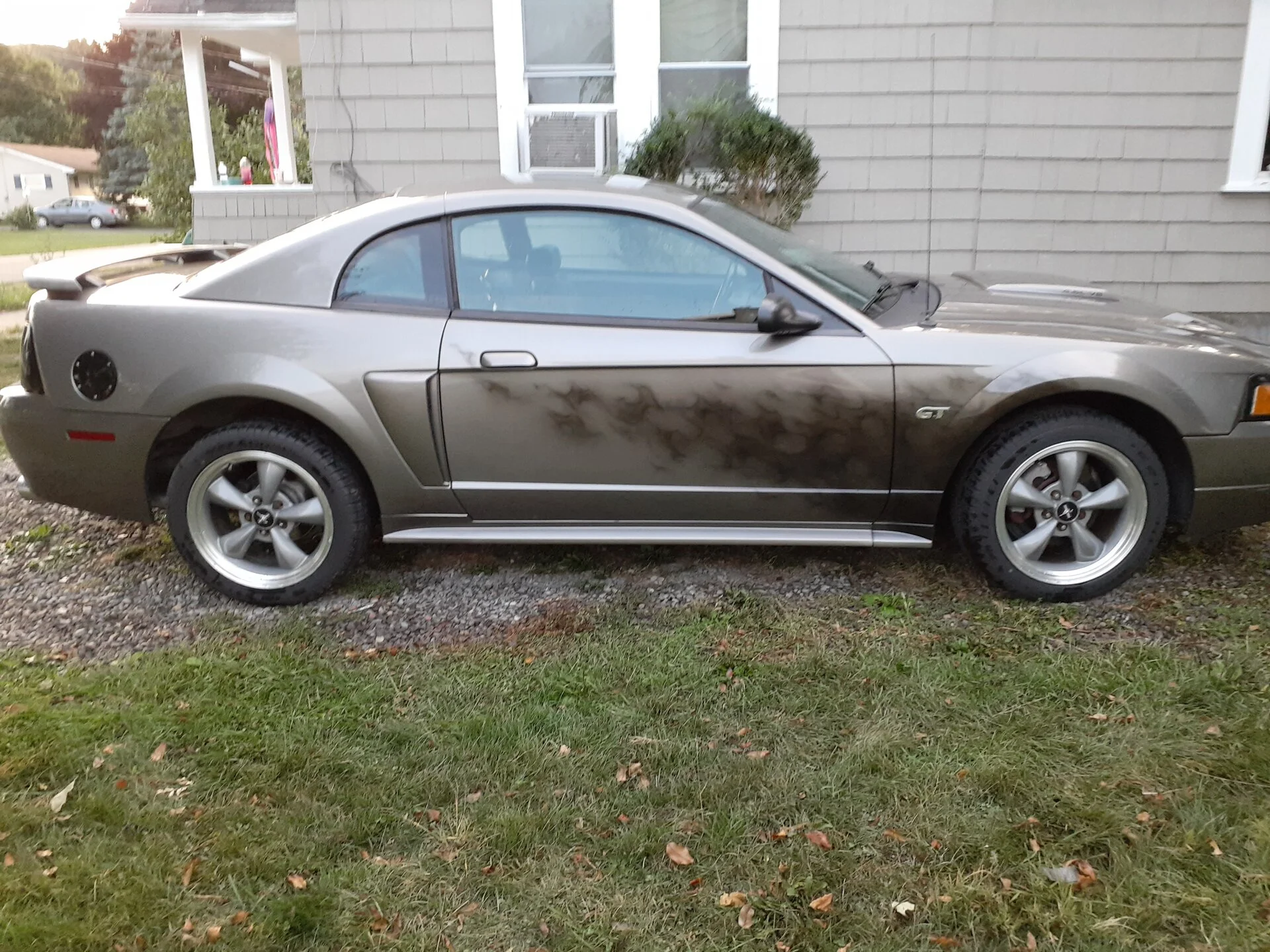

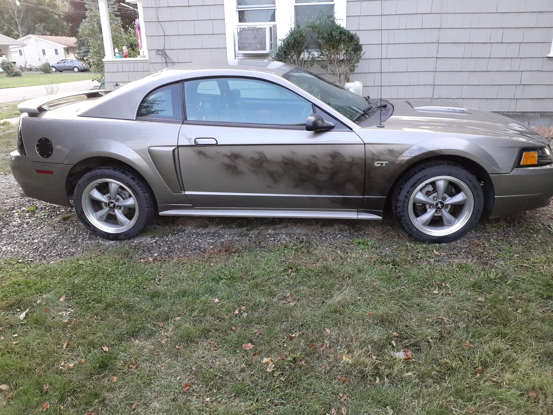

Hi guys i have posted a couple threads on here with some good feedback.my 02 mustang is a beautiful car with only 74,000 miles on it The paint is excellent and it has air brushed black flames on both doors.Anyway I do have a little bit of lifter noise ,very minimal and engine runs great! Until now.I seem to have a knocking noise that sounds like it is coming from underneath the car and behind the drivers side tire. It's not just a little lifter sound but almost sounds like a knocking sound that accompanies the lifter sound now.If I am in neutral and parked and open the door,then push the gas down I can hear knocking coming from what appears to be underneath the car behind the drivers side tire.Bottom of motor I think.Almost sounds like a diesel engine underneath there? If I push the gas down it seems to knock faster the higher the rpms are.Almost sounds like I got bad gas with it knocking.I did just get gas 10 minutes before it started knocking underneath.Maybe it is a coincidence? I just picked my car up from my mechanic today and had a McLeod street pro clutch and flywheel with bbk clutch cable installed.I am getting noises from clutch already soon as I left the shop.i am hearing a fast clicking sound liKe a dead car battery makes coming up through the dash which is something with clutch or cable?My mechanics son always wants to race me with his boosted honda everytime I go in there.I am wondering if he screwed up my engjne because when his dad put the clutch in he let his son test drive it.Mg stomach sank when I heard he drove it.He probably beat the piss out of it because It absolutely did not have this knocking sound
Before I took it there! A little bit of lifter noise yes but it was actually pretty darn quiet.My mechanic said it's one of the best 4.6 2 Valves he ever listed to and it sounded great to him.He also said car has no bottom end noise whatsoever.This was a week ago.This car is like my child so I need to know what I got to do to her so I don't have to pull the plug so to speak! Thanks a lot from one dedicated mustang fan to another.

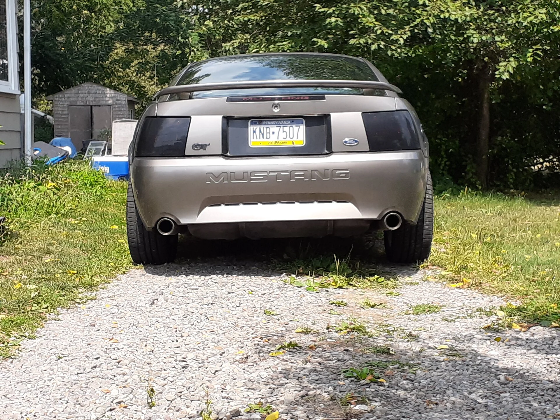

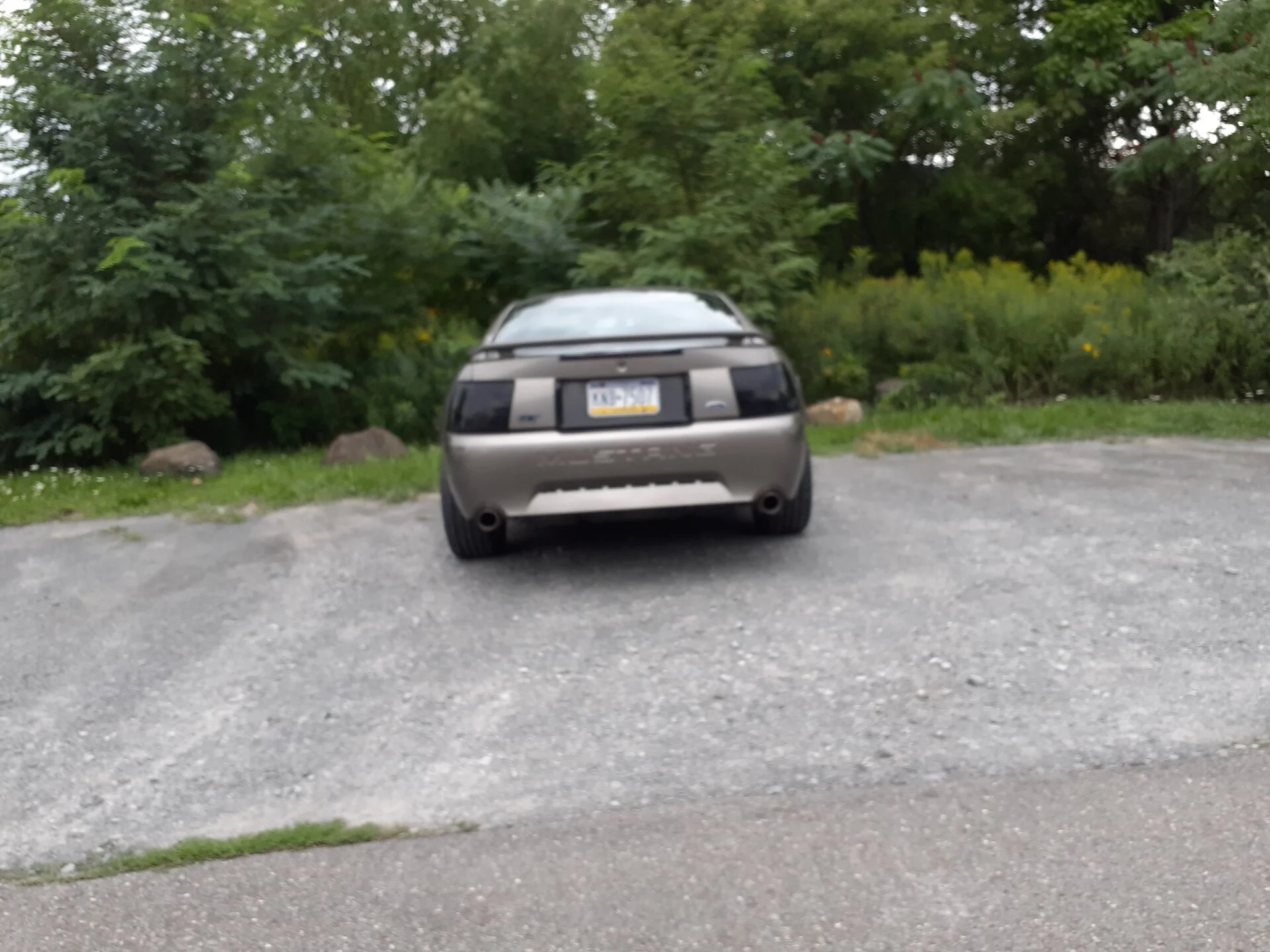

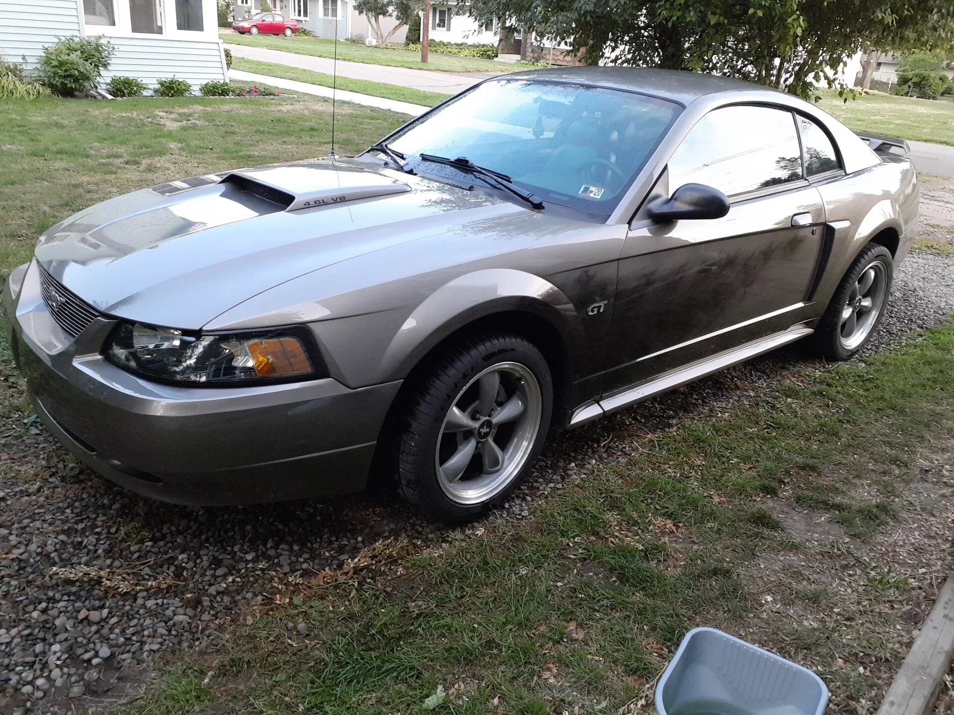

So does my clutch seem normal?It shudders backing up in reverse and then in first pulling away.It also seems like I am popping the clutch in third but I am not popping it.It just seems to pop like I am trying to pop it.Only does it in third.I could swear that it seems almost like a slip sometimes but the rpms don't seem to jump with me accelerating like a slipping clutch does.The rpms go up but you really aren't moving.It is a couple days old.if this sounds like an issue and it has to go back could someone let me know.Thank you!
My stock clutch did not do this.No shuddering and it didn't slip when I changed it.I had a bad throw out bearing and pilot bearing is why I changed it along with a bbk clutch cable.I want to supercharge it but it would be a shame to put it in and blow the motor and have to start over a gdx ter putting a ton of money into it which I have.
