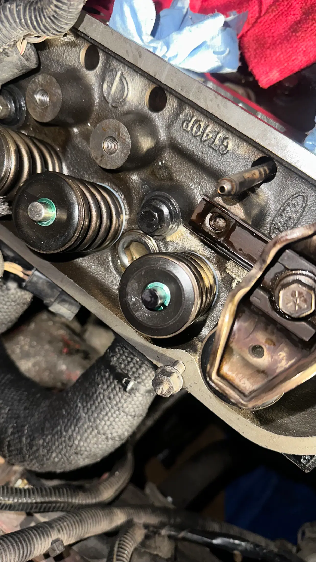

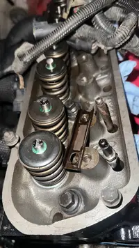

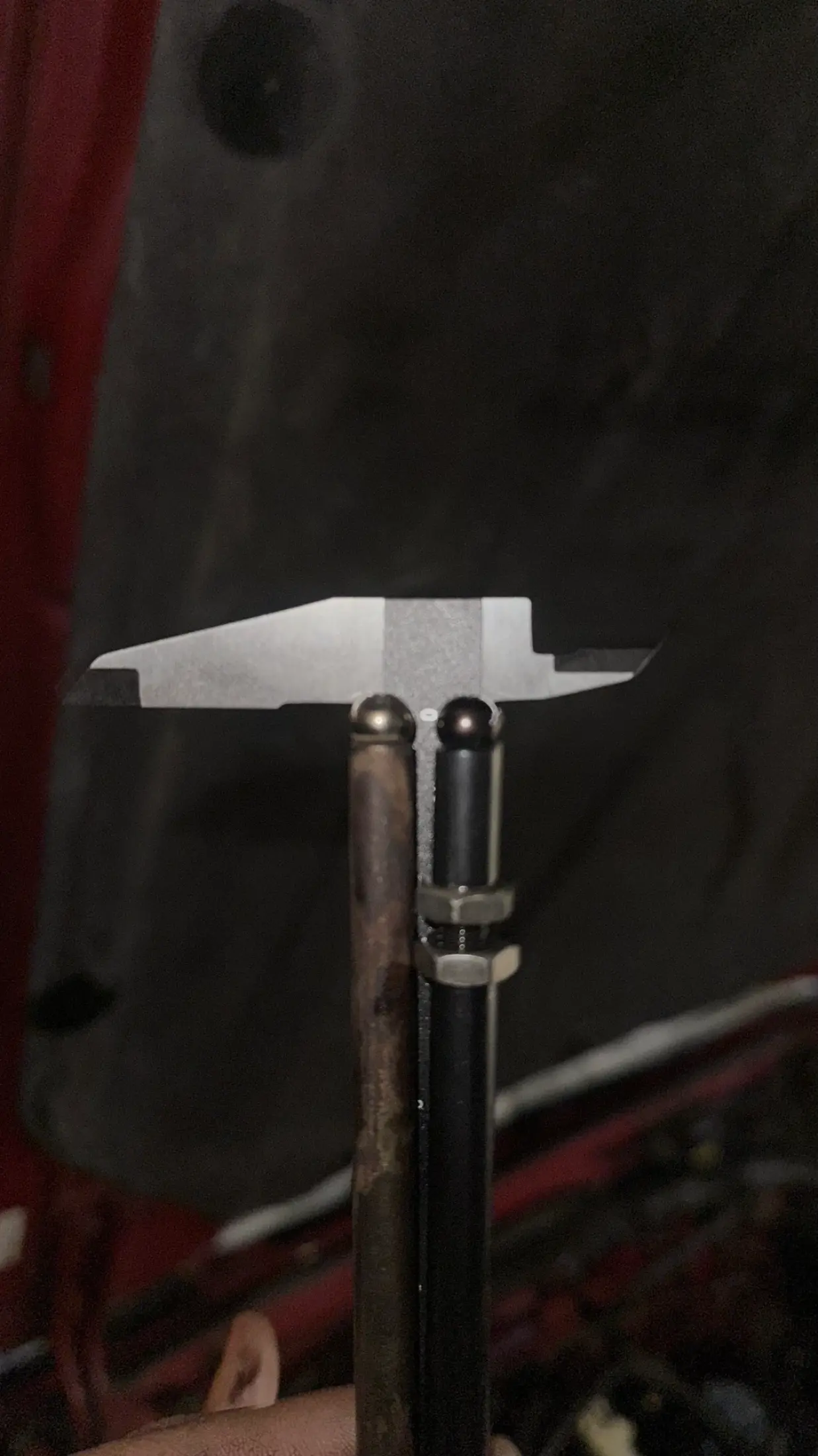

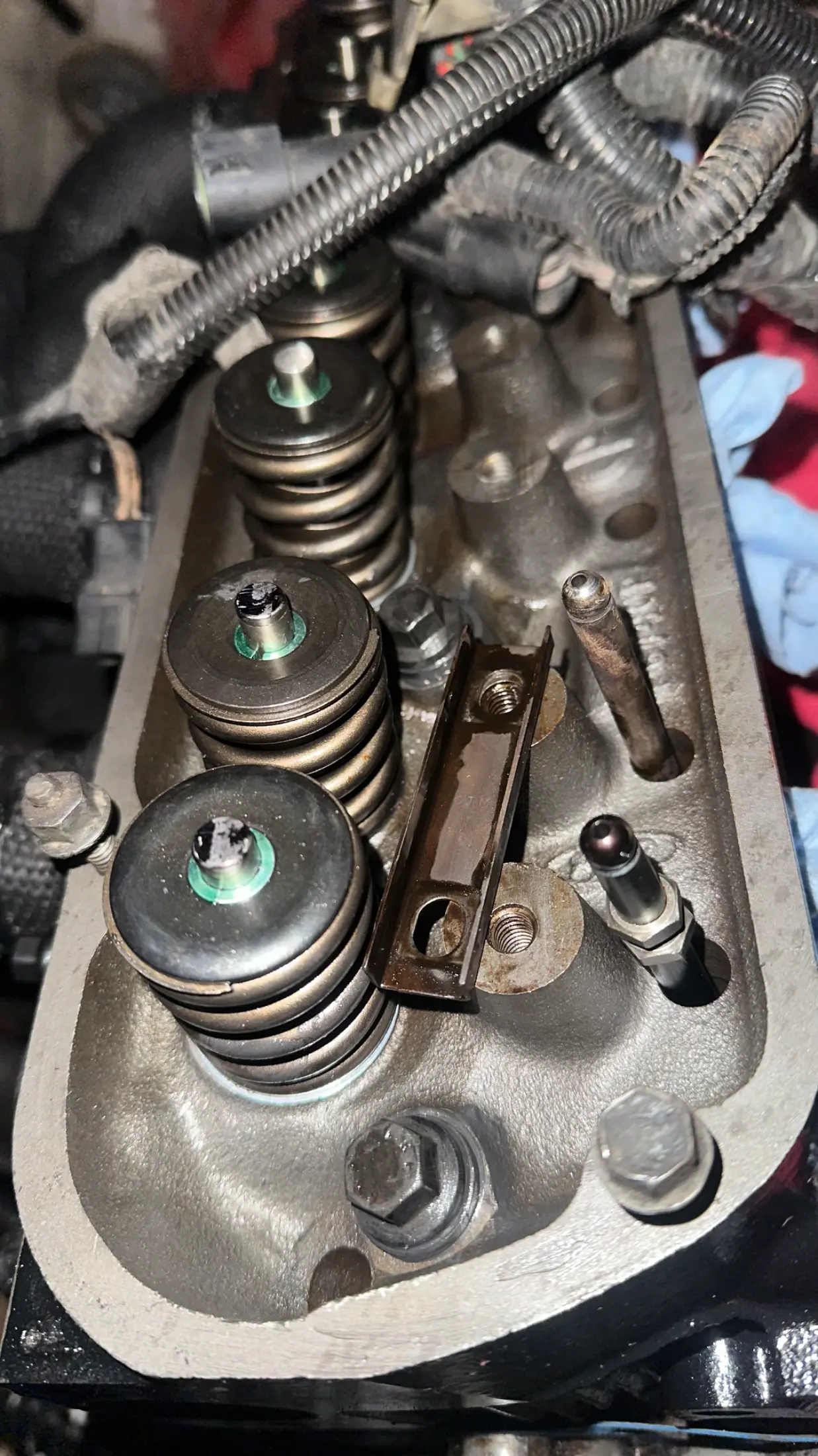

Hey guys so I’ve got the heads on and am starting to put the rockers and pushrods! I measured the pushrod length by tightening the rocker my hand and then expanding the checker to zero lash, did I do it right?! It is the exact same length as the stock pushrods that I have. I’m going to be reusing the stock pedestal rockers and am having doubts about the sweep since it’s pretty wide, is that how the stock ones are meant to be?! The left one is a little off but I misaligned the rocker
(Left is pushrod, right is adjuster to zero lash)

If your sweep is close ( contact on the valve stem by rocker?) I think a good valve train geometry is much more important.... You can see this when hand cranking with the valves adjusted...
I also prefer more " tightening turns" for street use...... 3/4 to 1 turn VS 1/4 to 1/2 turns..... The less turns give you a noisier lifter has been my experience...
