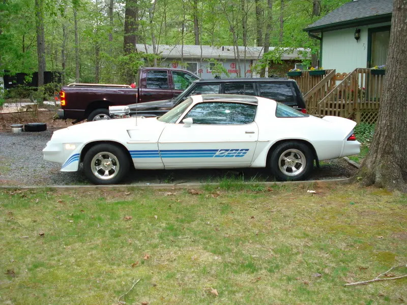

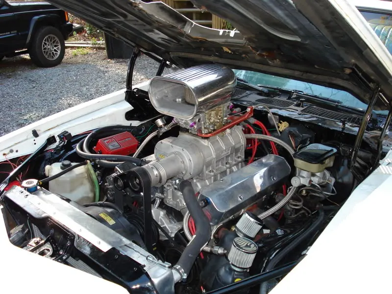

Yea I hate to do it. I have quite a bit of work in the z28. I think the mustang is a fair trade. There is a ton of money in the mustang and it is a little more daily driver friendly. The Z28 probably only gets 6 miles to the gallon.

Still its a nice camaro.:nice: Its also not a turd-gen(a camaro guy actually told me that one:) ) so the build quality cant be that bad.
