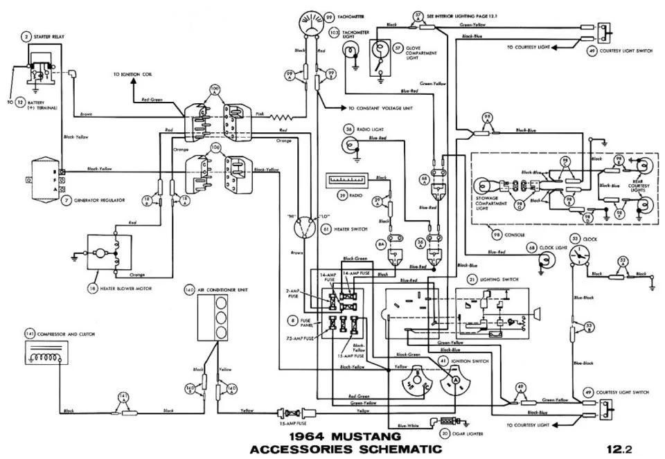

Is the under dash harness the original factory harness? If so, there is one wire that is switched 12v coming off the ign switch. On the 64 1/2 it should be a red with green strip wire. THat wire would turn into a pink wire which is the ballest resistor wire, then when it passes through the firewall plug, turns back into a red with green strip wire where it goes to the coil +. THat's the factory harness. You sould have 12v into the ign switch on the large yellow wire which should be battery source. Make sure you are getting 12 into the ign sw first. If you don't have 12v on the red with green strip wire in run and start, then you might want to suspect the ign switch. Make sure you have the brown wire connected to the "I" term of the solinoid-this is how you get 12v to the ign in Start. THe resistor wire is bypassed to give the coil a full 12v signal for starting. I'll try to link a diagram.
