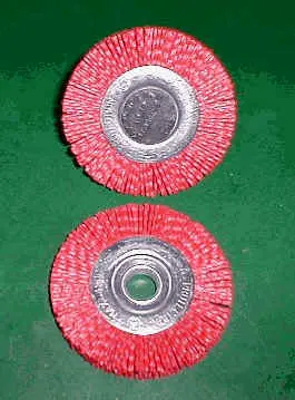

For cleaning up oxidation and the usual crud that you find on them, the cleanest thing I can think of is either going to be a scouring pad (depends if it'll be abrasive enough) or a nylon brush wheel on a drill. Like this thing:
I do lots of general cleanup with those, they work quickly, nicely, clean up junk and dirt and so on. You can get a nice brushed aluminum look with one of these too. I believe the red ones are 120 grit and the blues are 150 or 180. It doesn't eat up aluminum and sand it down enough to really make a mess, so leaving the alternator assembled shouldn't pose a problem. I've cleaned some up in that manner and they came out very nice. There could be other ways to do it too, but I don't know them.

Hey Mansonozz, thanks for the help. I live right in Worcester, is there anywhere local I can get those nylon wheels your talking about? Also, once I use those wheels on the alternator I imagine it will eventually go back to looking like crap, is there anything I can brush on that will keep it looking ok?
Nothing that I know of. The thing with these is they clean up the dirt and crap like that but they don't exactly strip the casting coating off the aluminum. Because of that as long as you keep your engine relatively tidy it shouldn't oxidize and turn to **** again. If you were to sand it down and not fully polish it, THEN you'd have that oxidation problem in no time.
YOu can get those at Sears, I think they're 8 bucks. Lowe's, Home Depot, etc. as well.
