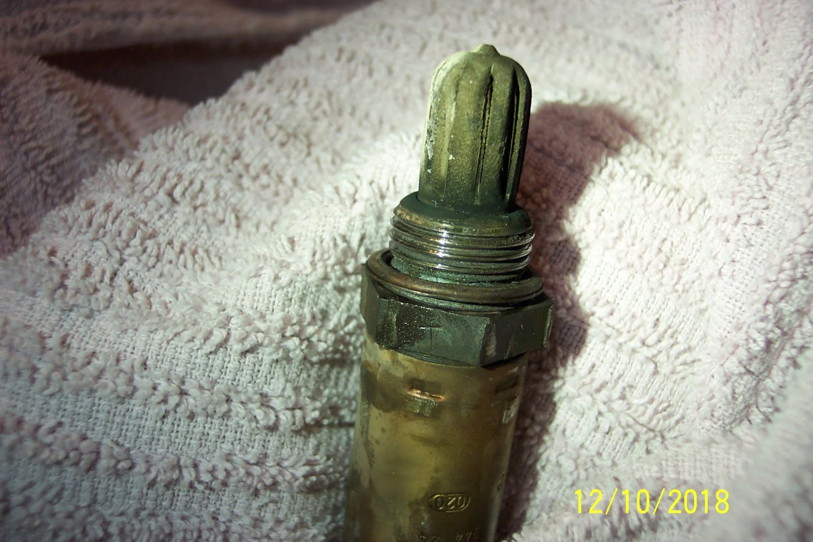

Attached are pictures of the O2 Sensor and they are original equipment 1984
Will replacing it take care of the code and Ping?
What are these things supposed to look like?

Yes. The O2 sensors are a problem and need to be replaced. They are a time change item designed to last for 30,000 to 50,000 miles.
What's more important is the overall condition of the rest of the engine. Putting brand new O2 sensors into an engine with a lean condition will effectively 'wipe out' those brand new sensors.
While it is true that a malfunctioning O2 sensor can cause an engine to run poorly; It is also true that a poorly running engine will kill an O2 sensor.
What I mean by all of that is that "yes", you need to change the sensors but changing them is not likely root of your issues. I would also be looking very hard for bad gaskets and hoses. Anything that might lend itself to a vacuum leak.
What are these things supposed to look like? View attachment 617461 get rid of the PING
Though not shown as a category in the above line-up, I would say that yours fall into the "Completely Toast" column.

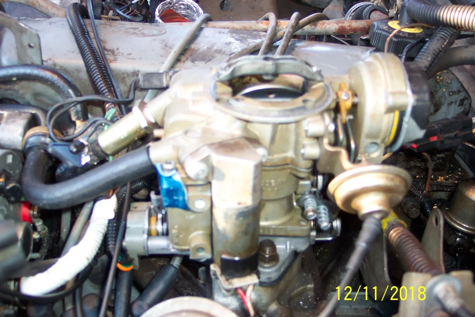

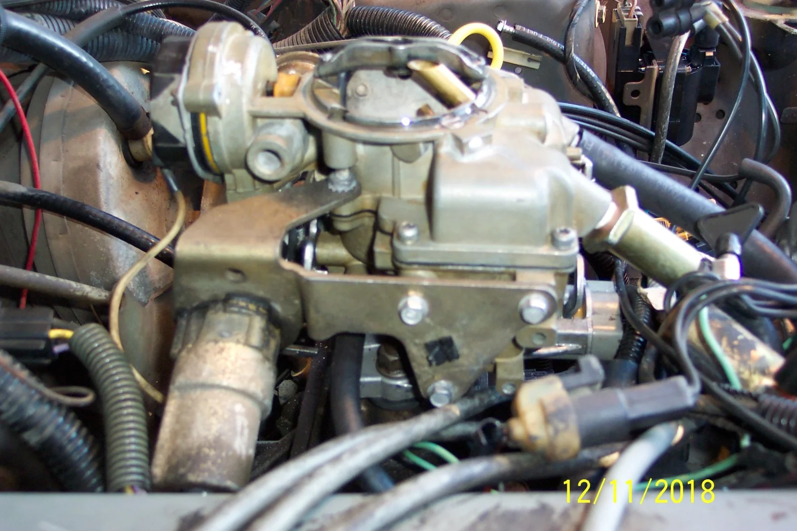

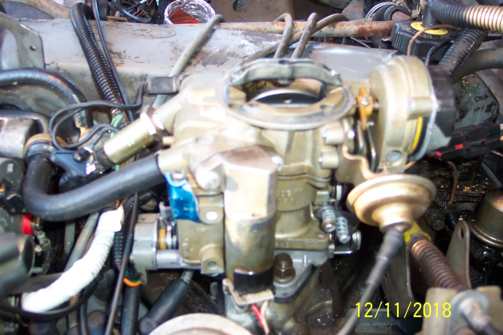

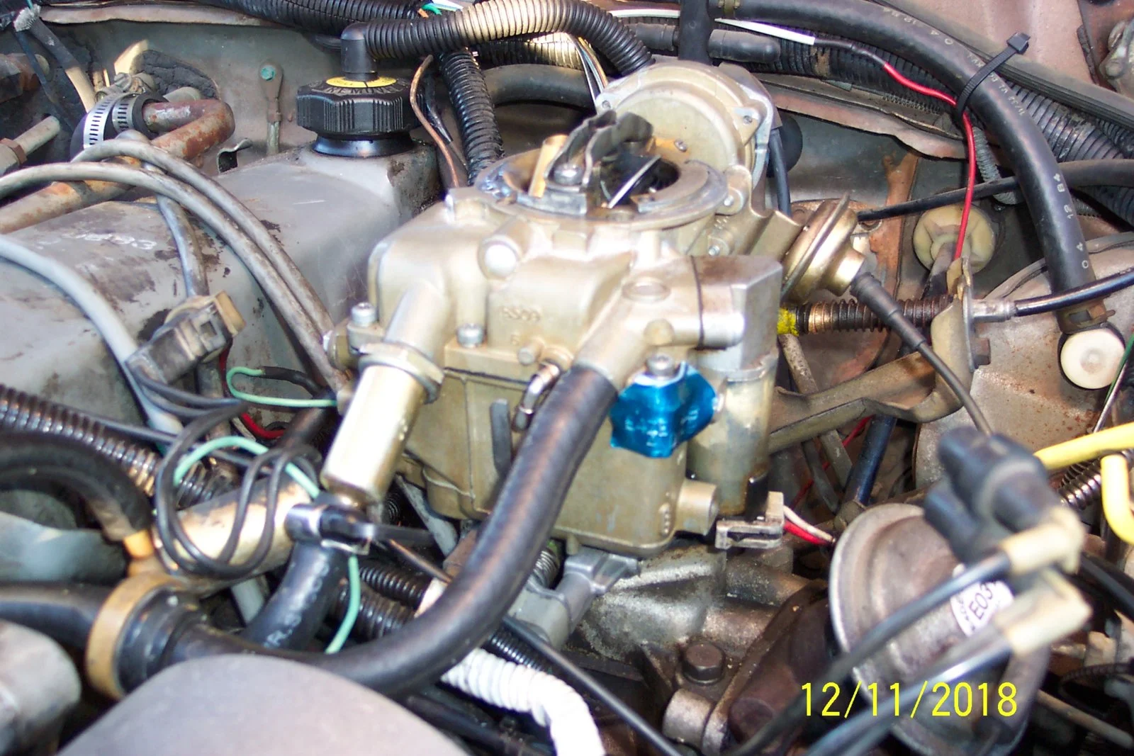

Pics... I was guessing you had an old style throttle body. What fuel pump is installed?
It's a YFA-IV>>> I put a new kit in it from Mikes Carburetor Parts>>> The Fuel Pump is Original>>> This only has 105K miles on it>>>
I am Fanatical about changing oil, I bought it w/42 miles on it>>> I have pictures of the Carb inside and out before I put the kit in.

The only electronic part on the carb is the Fuel Control Solenoid (see pic)...that's that thing on the left screwed on the carb with the wires coming out the bottom>>>thats got to be the only control the computer has on the carburetor>>> I need to get the O2 sensor and see what happens>>>
