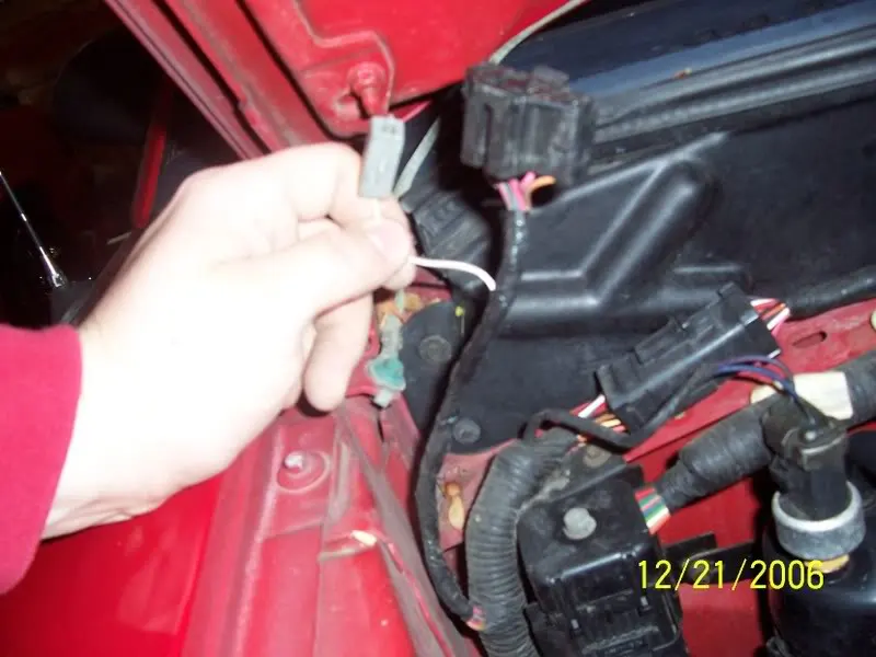

Are they easy to use ?
Where do we connect this ?
I or II for our car ?
I might have an opportunity to buy one, i'm studying in electric engineering so I will have no troubles whatsoever connecting those or whatever but I just want to make sure that i'm buying the right one. I'm very tired to always have the CE light on and never know what's the problem.
Thanks!
trav_19
Oct 29, 2006
810
Jackson, MI
Mar 9, 2007
  • Mar 9, 2007
i think its odb 1
and i believe this is the hook up here

^^ Thanks,
anyone can confirm that ?
m0l0
Nov 20, 2005
178
17
Mar 9, 2007
  • Mar 9, 2007
Confirmed , 5.0 94-95 uses OBD I, 94-95 V6 uses OBD II, and if you are looking for something cheap and in case you are lazy for counting blink codes ( as i am ) use this one its cheap and the most easy code reader to use on OBD I cars. :
http://www.midwayautosupply.com/pc-7208-90-equus-digital-ford-code-reader-3145.aspx
For 29 bucks its a hella of deal
