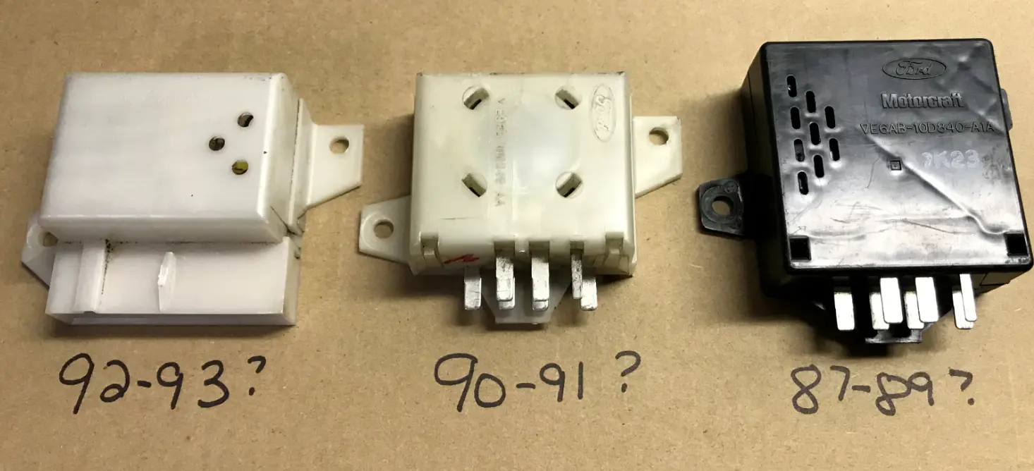

There's a little box under the driver's side of the dash with an actual speaker that chimes when the key is in ignition, lights are on, or the door is open. There's an actual speaker in the box.
These units are old, and failing so the sound may get quieter or start sounding..bad. Have never pulled one apart to see if the bits can be replaced.

I just did mine...
There are YouTube videos showing how to fix it..
it’s easy and takes a few Minutes once the box is out....
Basically, Remove the box 5L5 showed you above, open it up and replace the O-ring inside with same or similar size... that’s all it is... in my case it made It loud again...

can anyone take some accurate measurements with a caliper on the o-rings. Would help to identify the standard size they are for future reference.
I imaging all theee units use different sizes
