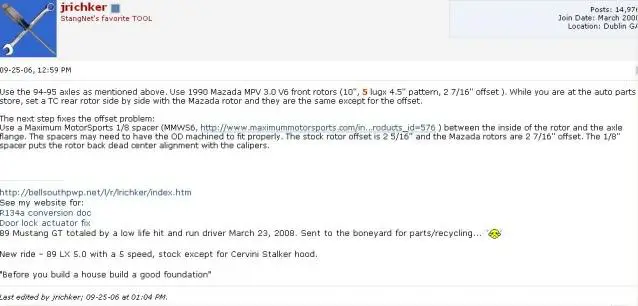

Anyway, but I did have a reason for the post... I am about to convert my 4 lug TC rear to 5 lug... the 16x8's (95 cobra r 15mm offset) and 245/50-16's I am running dont fit well... especially with the Steeda Sports... and I cant find a wheel with enough offset or backspacing to suck the wheels in further and stay 4 lug. So I'm going to swap to SN95 axles and MPV rotors with MM 1/8" spacers, and then my choice of wheels will increase drastically... I might even run 5 lug Pony R's in back and 4 lug Pony R's in front... no one would see... it would just be a pain to get a flat.

I am not going to do a rear drum swap, I already have discs.. You take out the Turbo Coupe axles and rotors... put in 94-98 axles, a 1/8" Maximum Motorsport Spacer, and 1990 Mazda MPV 3.0 front rotors.. and wala! 5 lug disc brakes in the rear and the myriad of wheel choices and offset possibilities.

I'm not a big fan of putting a spacer inside the rotor. I'd definitely upgrade the studs if you go that route. Moving the rotor away from the axle flange increases the moment arm acting on the studs during braking and increases the risk of snapping or bending studs.

true story... I dont like it much either, but it seems like a pretty easy swap. I will definitely take that advice. You have any preference on which wheel studs to use?

MPV rotors 50ish, spacers from Maximum Motorsport 30ish... upgraded studs for 20... that leaves 20 bucks in my pocket.
plus I just dont think that a 1/8" spacer is a huge width of spacer especially for the rears. I dont drag race, and only autox a couple times a year, this is just a mostly daily driver for me. I'm just not sure the 1/8" is going to be a drastic change.
