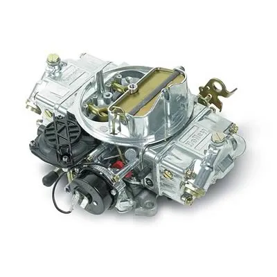

  • #19
Yeah, I have the MSD retard box sitting at the garage just not plugged up. I'm thinking I'll need to wire it up to retard when the window switch ingages the nitrous from 15* to probably 10*
I'm running what ever is stock on a street avenger 670, my car is at the garage or I would go and look.
Here is a pic from summit but I can't tell from it?
