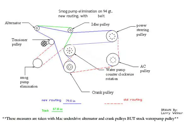

Whell, i want to share the power, so here you guys go, i had pixxar create an image about short belt routing. The belt you need is a 3038 size. i forget the actual size in inches, but ask for that size, i know autozone has em. Here ya go:
:hail2: :hail2: :hail2: for the wonderful picture :lol: I think its an 81" belt needed for it... I could go look on my car, but not many people seem to care about just bypassing the A/C and smog... I think I squeezed an 80.5" belt on my car with the smog and A/C bypassed.
i got and 805k6 as they call it .......80.5" belt on mine with the ac and smog gone.....and underdrive pulleys....i bought a cheap belt, it slips so the next one i buy will not be cheap because they stretch......so i advise anyone who gets the short belt to buy a goodyear
jason
I used a cheap $20 belt from Discount Autoparts for my car with the smog and a/c bypassed and its been on there for about 1/2 a year now and hasnt slipped... Its still a struggle to get it back on when I take it off.
I was kind of curious about the power steering too. I know for race purposes you can short belt your ac, smog and alt. but not having a manual rack are you gonna destroy anything from bypassing the power steering. I almost think that the car would not even be able to turn even when moving? I dont know just curious.
Yeah, the water pump turns the same direction in each of the drawing posted. I made a similar drawing a long time ago showing how to run a shortbelt bypassing the AC, PS, and smog, but the above one is better than mine. :LOL:
