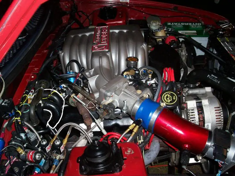

the heater core is like a small radiator and after time they wear and leak....you do not disconnect the ac from the heater core as you stated above....in the picture below remove the hoses circled in white from the firewall the fluid will drain out of the heater core then connect these two hoses together with a small piece of 1/2 in. copper pipe and 2 hose clamps this fix will allow you to bypass the heater core until your able to replace it but i would reccommend to replace the heater core before winter because you will not have any heat and the defrost will not get hot either.....

well im not going to remove the dash for heat, ill just reroute the coolant. here are some pics i just took. I was confused because my AC thing goes into the firewall too and i dindt see the heatercore hoses next to it. Is it possible its that and not the heatercore?

Your heater core hoses are those two hoses about 4" to the right of the A/C line.

yea i know, but i wonder where those ac lines are headed once they pass the firewall and if that could be whats leaking.

The AC lines go into the evaporator and they contain refrigerent which vaporizes upon release. They have nothing to do with leaking coolant. Unless you have a swamp cooler in the dash
