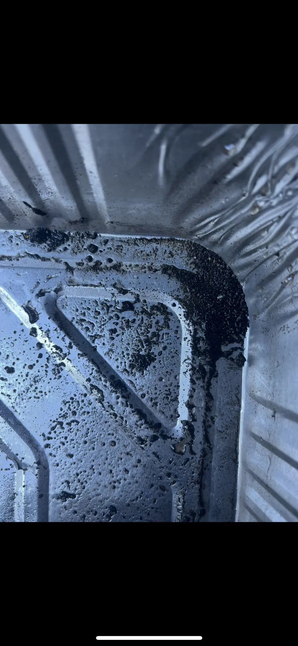

My foxbody mustang has been sitting for a long time and about 3 years ago I got it redone meaning re sealed the entire motor, since then the car has been over heating because the coolant kept getting dirty and I made sure it’s not oil it’s just mud or dirt, I’ve replaced the thermostat from a 160 to a 180 which made things worse so I’ll go back to the 160 and I flushed the rad and block and it’s still brown from dirt, my mechanic said it’s the metal heater core tube since I already by-passed it, what is the issue.
The photo is what keeps coming out of the rad. And it brand new with less than 500 km.

What is the debris? dirt, stones, rubber, that stop leak stuff some people like to use?
You say your car overheats with a 180 t-stat. Describe the rest of the cooling system - Rad (2 core, 3 core, OEM style or aftermarket aluminum)?, Fan (clutch fan or electric)? A/C or not? Anything bypassed or re-routed?
That larger piece of debris in the middle left of the pic appears to have a circular shape to it.... doesn't look like it's "just mud or dirt".... more like it's an edge of a gasket opening or an o-ring or something like that.
