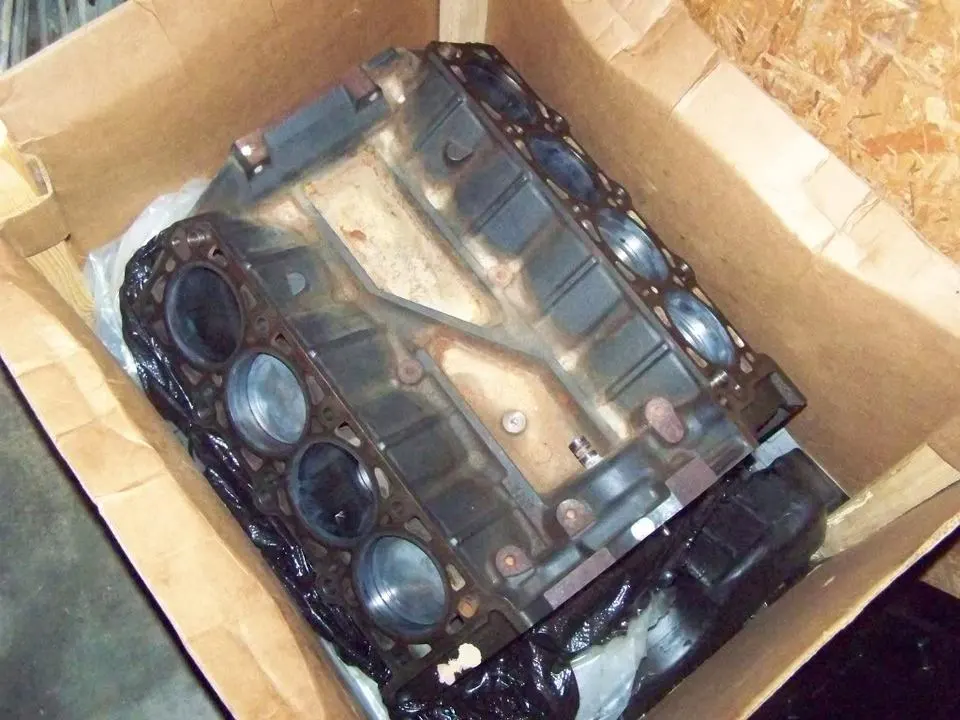

I know it's a bad picture, but I havent got it on an engine stand yet.
It's a 2004 Lightning 5.4 block, Lightning crank, Manley H beam rods w/ ARP 2000 rod bolts, forged dish piston's (9:7 compression), and ARP main studs.
I plan on going with some MHS stage 3 heads and turbo cams along with a PT-88 or a Bullseye S400(80mm). That along with an edelbrock Victor Jr intake w/ adapter plates and a 6061 plenum. I am picking up a 4R70W from a buddy of mine in a few days. I plan on taking it to BTS here in Arkansas to have them rebuild it and going with a circle D converter.
I am hoping to have it done by next spring. There are still a couple of things I am up in the air with. Can't decide if I want to do twin GT500 pump and all that, or just build a full return style fuel system w/ Aeromotive stuff. I also can't decide if I want to do a full manual valve body w/ a trans-brake on the car. It will be a 100% street car that will still retain A/C and powersteering. Just can't decide.
Also, my UPR tubular K member kit along with billet caster/camber plates, full length subframe connectors, and strange 10 way adjustable shocks and struts should be here mid next week, that will finish up the suspension.
I dont really have a goal for it Horsepower wise, but she better run 9's in the 1/4.
