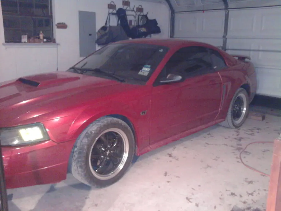

Well time has come to get the winter project underway which consists of new shocks/struts,springs and CC plates. I had help in the form of my dad which is great to have another set of hands and opinions on things. Today we were only able to get the front done but it already looks great. Had some snags on the way in the form of size of sockets needed but a quick trip to Autozone fixed that. The back end gets done tomorrow then its off to get an alignment. Should be back and on the street again Tuesday! Here is a pic of the car with the new springs up front and the old in back still. Just a phone pic but it looks more drastic in person.

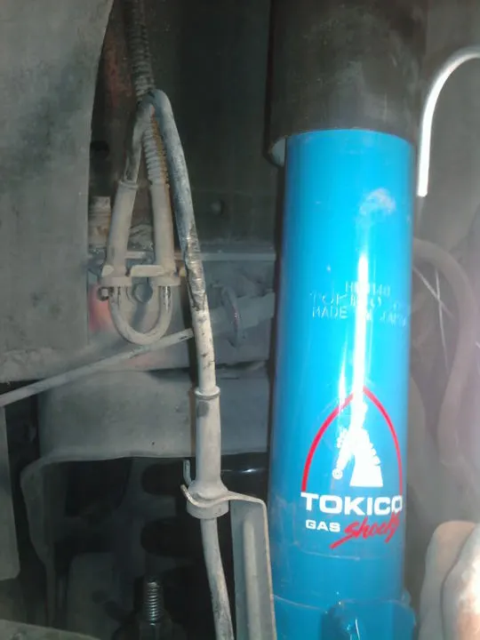

Also, this wire/line got streched out pretty good when I dropped the A-Arm, what is it and such? Also the tires have been doing a little bit of rubbing on it as well. Thanks.

I believe the wire is the ABS sensor, if i'm not mistaken.
Yes the wire is for the abs sensor. You can use a 1/4 box end wrench to remove it from the spindle. I would simply bend the bracket in ward to prevent the rubbing.

I got all of the parts new for $600 and the starter box is 1150. I really thought about it but it's the first car I have modified and I don't think I need the ultra top performace pieces on it. Plus, I also don't know what the drop rate on those springs are and I can't be having a huge drop in ride height. And I did bend it backwards, thanks guys for letting me know what it is though.

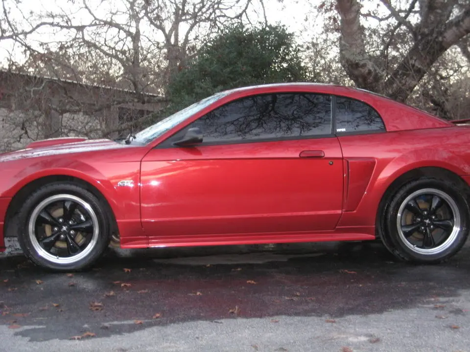

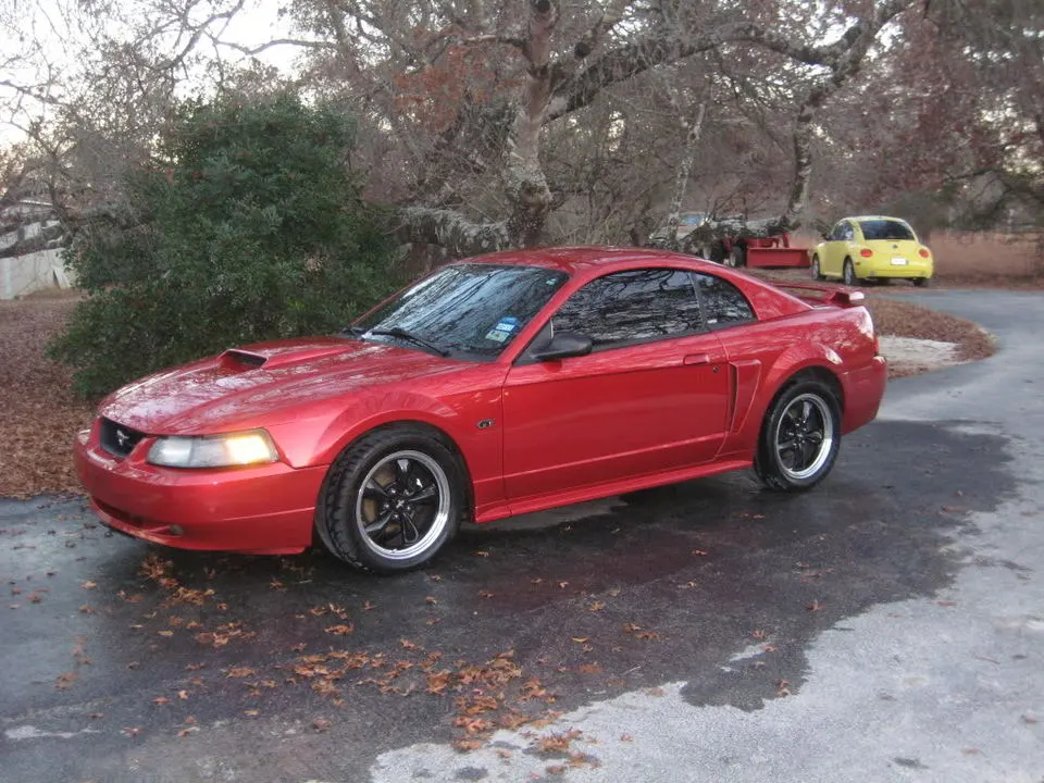

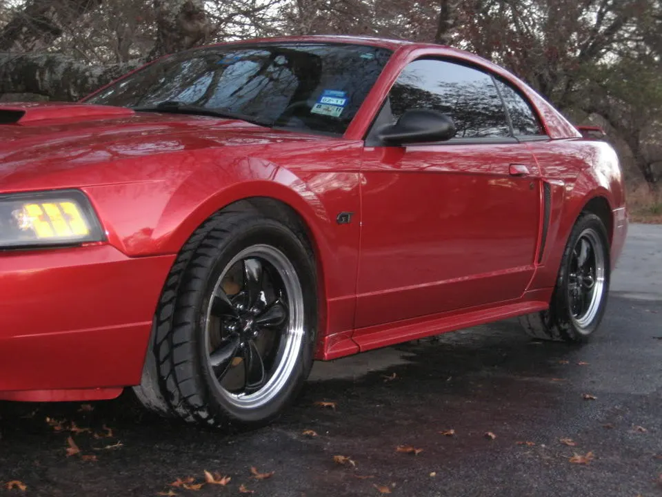

Here are the pics. The rear isn't quite where I want it but I'm not about to cut some of the springs to lower that. Besides, the rake look is starting to grow on me a bit. I just got my Cobra sideskirts too and will have them painted up soon! Next up will for sure be new headlights, just not sure which direction I will be going with those but definately not projectors. Had em before on the last mustang and hated them. Enjoy! :D
