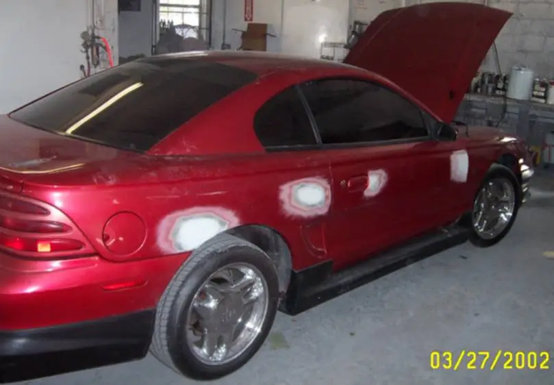

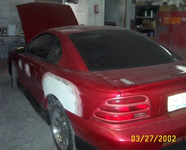

WHAT A FREAKIN MESS???? I have just about the entire car in pcs... :bang: Bout 1/2 way there...Hopefully to the booth next week to shoot it....
Got the hood installed, re-aligned all the gaps....Badge holes are gone...
Minor door dings and such....
Nose is done..just hanging there..
A shot of the new Drift Rs.....in 18"...nice dish on em
She's strip right down....
Doing all the prep here at home...she'll be trucked to the Ford garage for paint..then into the dryer...and Viola....Then another week to re-install everything...This is a freebie from a friend who works at a new dealership...5K paint job for just materials...I had to suck up the offer... :banana:

Looks like a ton of work. The wheels looks good with that lip.
How hard is it to prep your own car. Since this site is practically a how too site. Whats all involved.
Whats involved...First depends on what kind of job you want...This ones the full monty so everything comes off...the less masking the better as far a the look is concerned...mine has no rust at all...a big plus....its mostly chips/dings and clear coat was going South....
I have a friend who's doing it...i just do alot of wetsanding and blocking...We pretty much scuffed it with 320....Red Scotch-Brite it down after that,,,wash it like 4 times over..Then Hi-Build prime it.....hit that lightly with Black spray paint..this gives it a "guide coat",,then we wetsand with 500...if alls cool...hit it with Gray Scotch brite...wash it 4 times over again....it thats cool...then you put the color to it....From there...i thinks he hits the color with 1000...clean that again...then hit it with clear....then buff that out....
Not a job i would even tackle without someone who knows what the hell he's doing.... :D Im just watching and learning...
