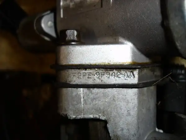

And my idle question, I have a good idle now, but its a little rough at times. While cleaning up the garagei noticed that the turbocoupe throttle body had what appears to be a IAC adustment plate (see photo) Is this worth installing? Any disadvantages to installing this?

I don't know anything about that IAC adjustment plate though.
