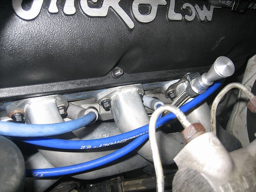

Here's a pic of my Lokar - it has the added benefit of not easily popping out if you are building up crankcase pressure with a blower... of course that pressure just finds the next best seal etc. :)

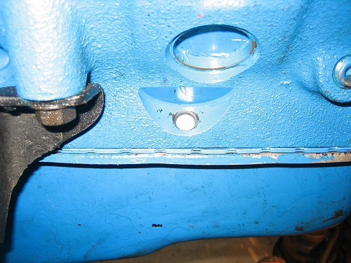

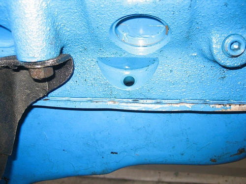

You'll also have to block off the stock dipstick hole if your aftermarket block has one.
I did this on my mach 1 by drilling the hole halfway down and then taking a plug shaped like a bowl that exactly fit the hole and hammering it with a punch, bowl side down and allowing it to expand out then putting a dab of RTV on either side.
