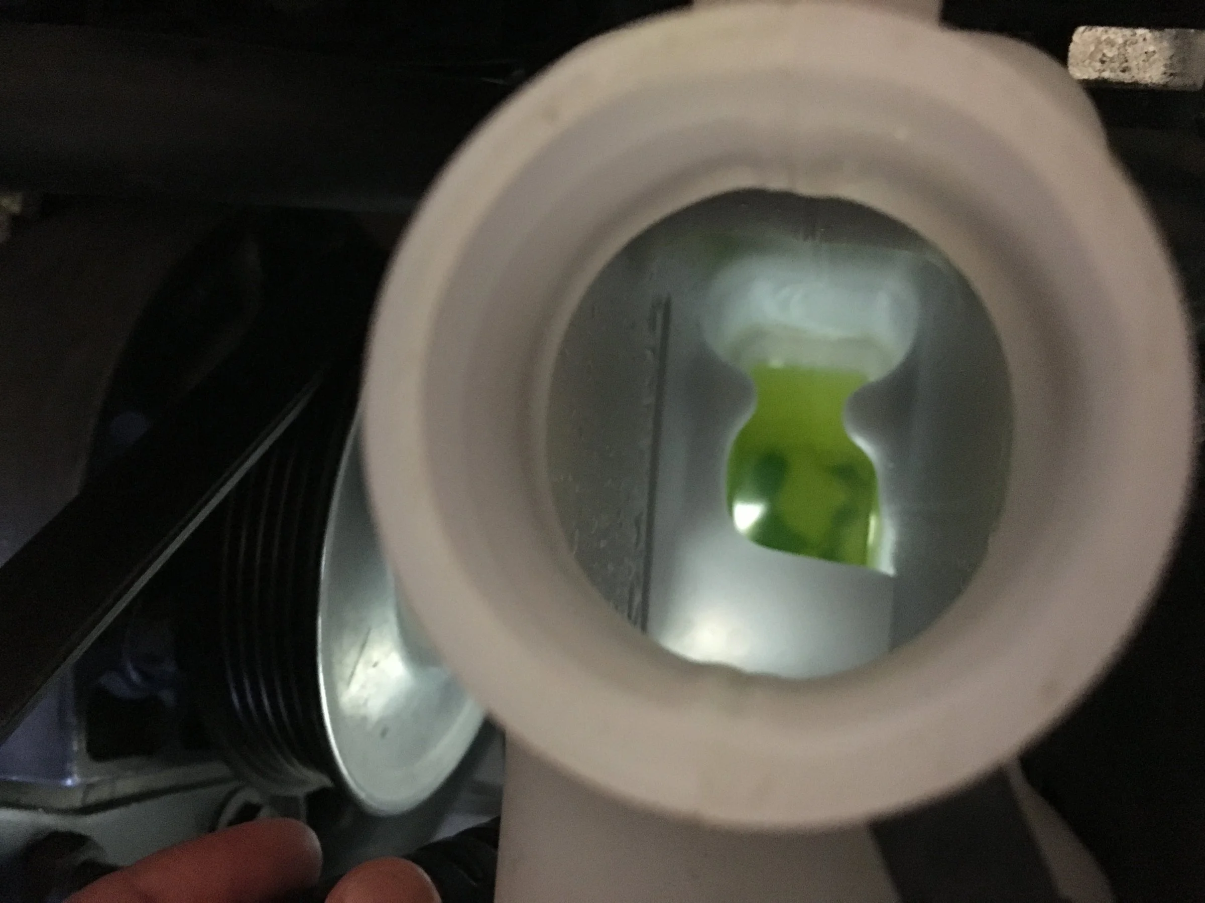

Hello. Finally got the Mustang out for a drive after throttle body and various sensors installed. Idle was steady, filled with fresh gas as she sat for a while, and went for a 30 minute drive. Upon return and inspection looks like were loosing a small amount of coolant and there is oil residue in the coolant reservoir.
Any ideas?? Block cracked or something not sealed? Please advise. Thanks guys!
check your oil. if it looks like mlkshake or really light coffee, you have most likely either an intake or HG gone bad. That being said. why is there no coolant in your overflow? What does it like look inside the radiator. is there a film of oil on top?
Oil normally floats on top of water because it is lighter. You may have some sludge from the cooling system settling out in the coolant reservoir.
Oil looks good, coolant in reservoir is at "Full Cold" or half in below. Film around wall of filler neck. Head gaskets replaced two years and under 1000 miles ago. Thanks for reply.
Best case scenario it's sludge. Probably a good idea to get it tested for peace of mind. Thanks

I'd drain the overflow out, flush it with water and soap, dry and reinstall and top off.
Go for drive and see if it happens again.
That reseviour looks new. Recently installed?
