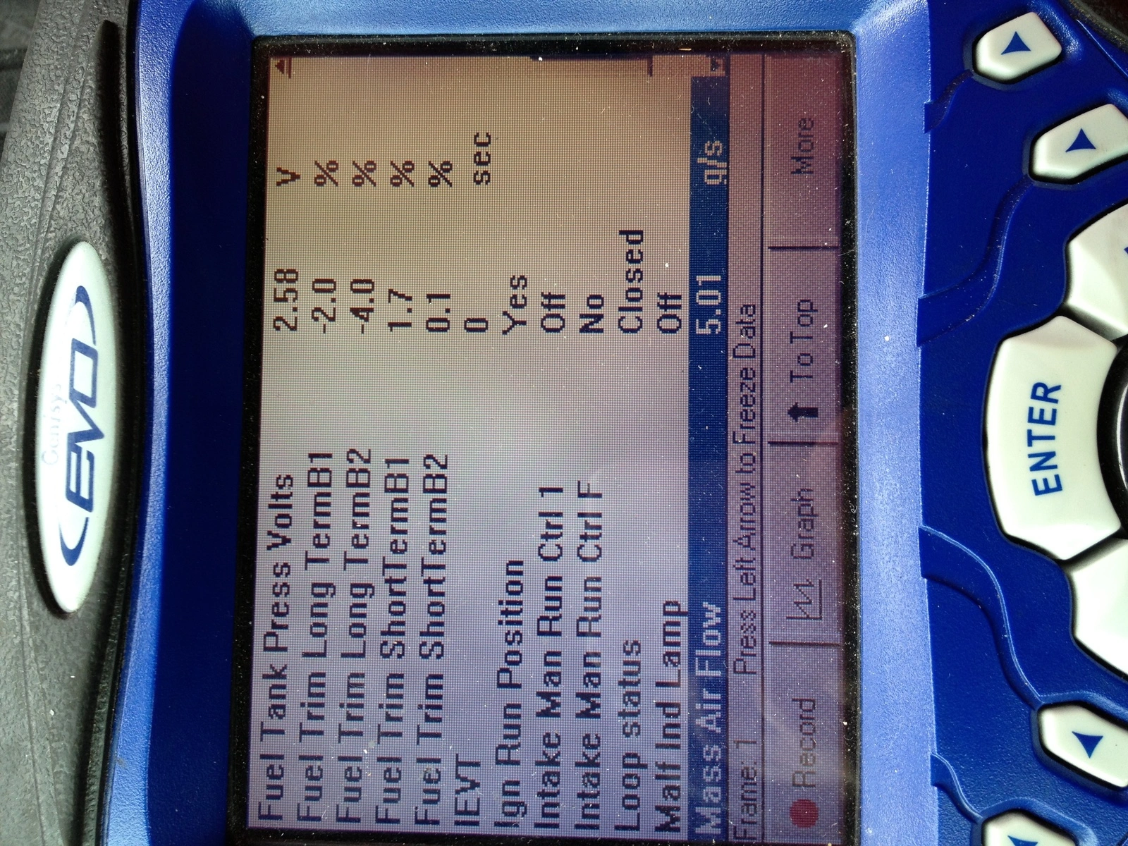

Well can I get your feed back on what you think....I'm new to the whole pcv drain/filter setup I never heard of it until I thought of it myself and saw it was actually a common fix/upgrade! I was an ase certified tech for 8 years and fixed almost anything on any car (we did not like to turn anyone away) take a look at the I posted with this reply and tell me is something seems off.....it's always a good idea to get a second opinion! View attachment 81235 View attachment 81236 View attachment 81237 View attachment 81238
