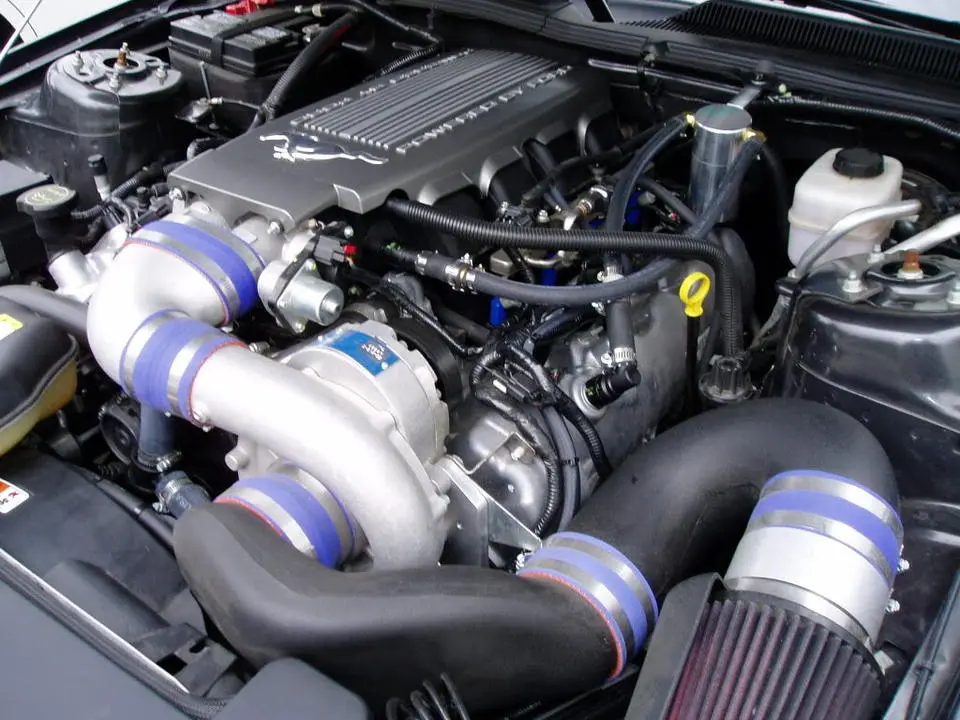

I added a PCV valve in line with an oil seperator on my supercharged 07 GT. No more oil in the throttle body or intake manifold.
5.0 , Boy does that set up look familiar. Looks like under my hood except for the seperator mine is a bit different. Non-intercooled? any plans for intercooler down the road? I've been thinking about installing the intercooler next summer got to save some money for that over the winter.Happy motoring.

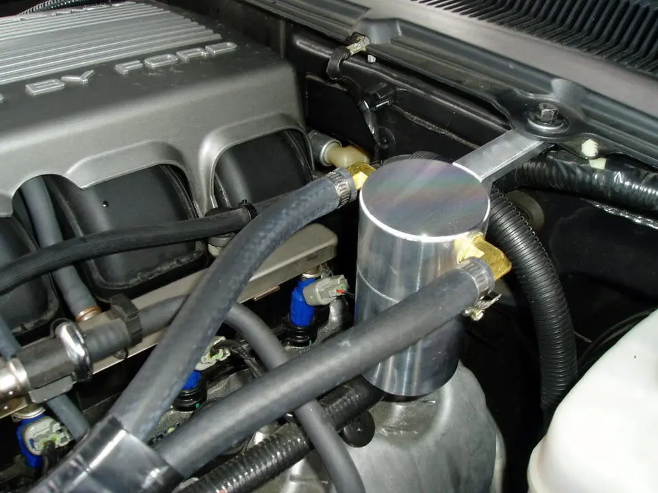

The girlfriend took my car to work right now, but I'll take a picture of it whenever she brings it back. :D
It's pretty much identical to the one pictured here that Steeda sells, but mine hasn't got a bracket to hold it in place and I built mine with brass fittings instead of the plastic ones.
Google Image Result for http://www.steeda.com/products/_high_res/555-3710-oil_sep.jpg
It cost me all of about $20 to make, vs $70+ to buy. :nice:
Erzats, I'm actually going to install the water-methanol injection kit from Snow Performance. Not only does it cool down the intake charge (like an intercooler), but it also raises the effective octane of the fuel, so you can run even more timing than you could with an intercooler. Not to mention, it's a lot less expensive than adding the intercooler after-the-fact. I've been told from various sources that the water-methanol injection is good for at least 100 rwhp when tuned to take advantage of the cooling and octane enhancements it provides.
