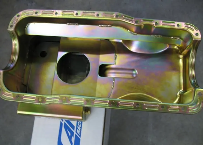

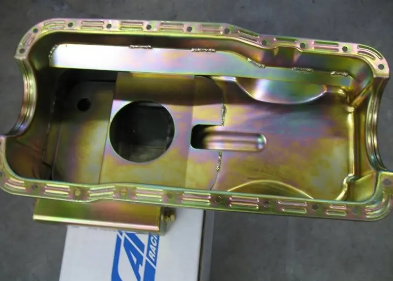

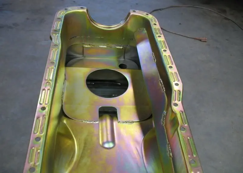

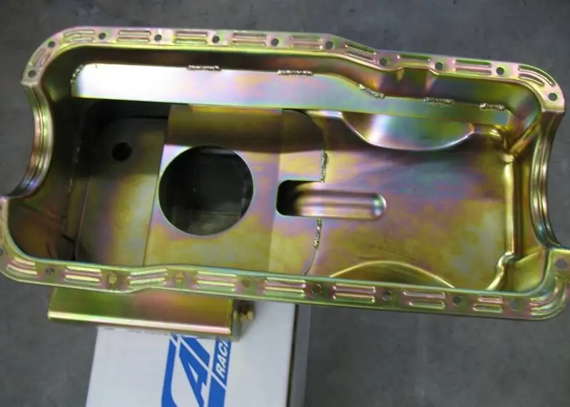

I got the Moroso Road Race oil pan. P/N 20505
Don't mind the water/oil mix at the bottom of the pan, it's taken care of. :rolleyes:
At least you can see the baffles and the doors.
I haven't driven the car yet with it, but it looks like it will get the job done!

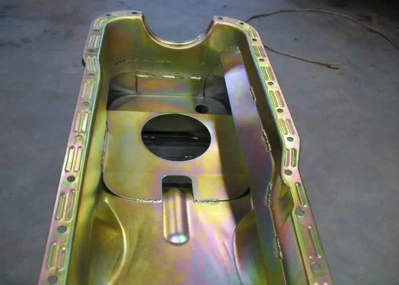

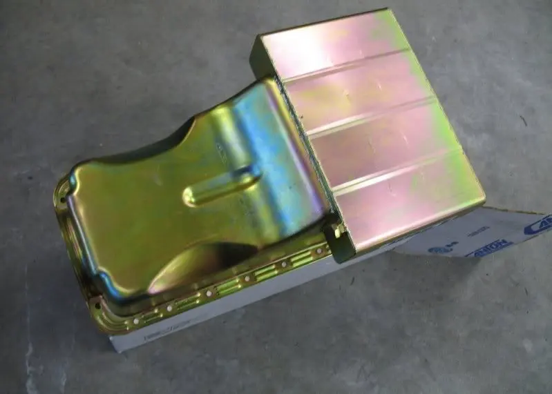

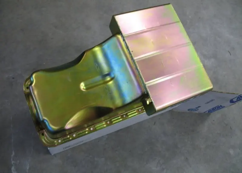

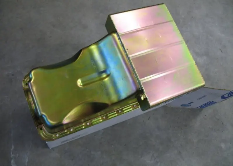

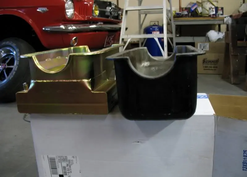

Pics of the 7 quart canton for a 351w:
Take note here of the bottom rear of the pan, this one fits motors with a main girdle, the center bottom portion has the "kicked out" center that allows the room needed for a girdle's studs. I went thru this in finding a pan to fit my 331 stroker in my 77 Comet. Not all the front sump pans work with girdles, unlike the rear sump models, even the stock Fox body "dual sump" pan clears a girdle.
ahhh yes, i believe that is also the one that has some interference problems with some inspection plates as well.

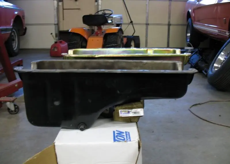

When I built the 393, the Canton pan scraper only needed a little tweaking. I am also running a Ford windage tray so that may be the reason I did the tweaking.

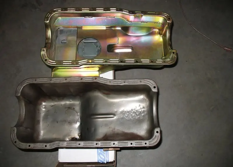

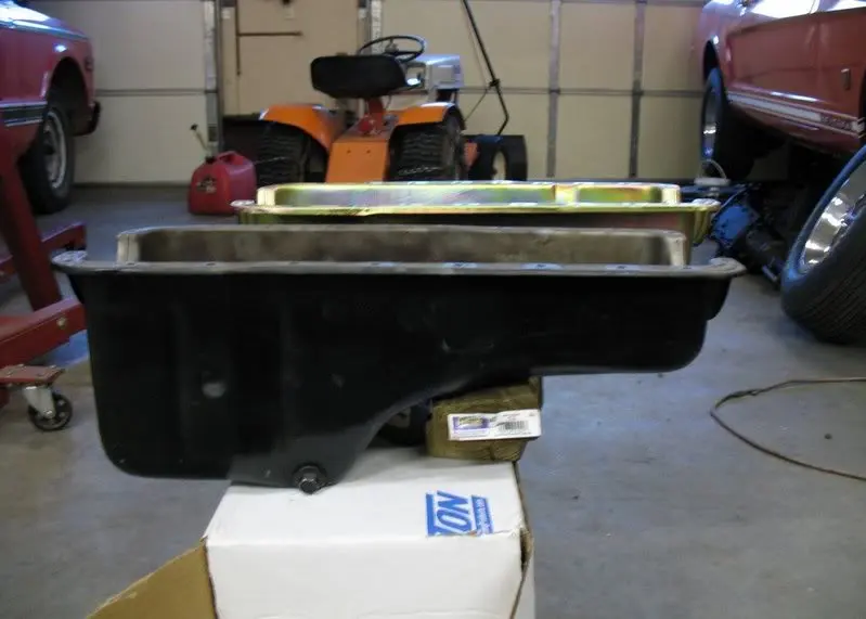

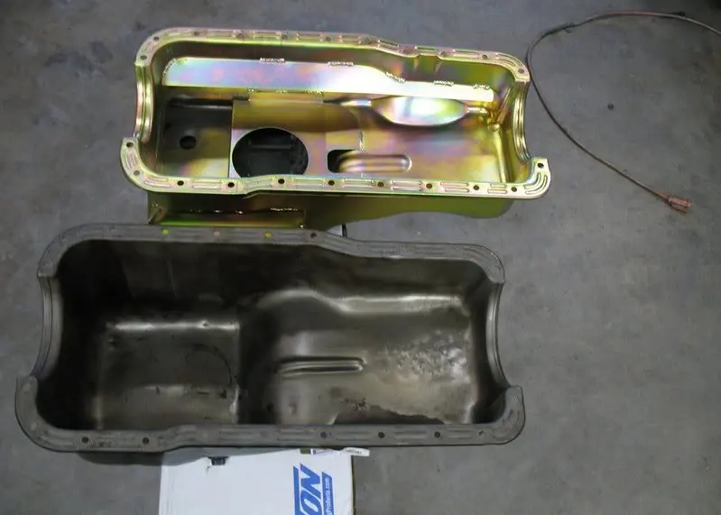

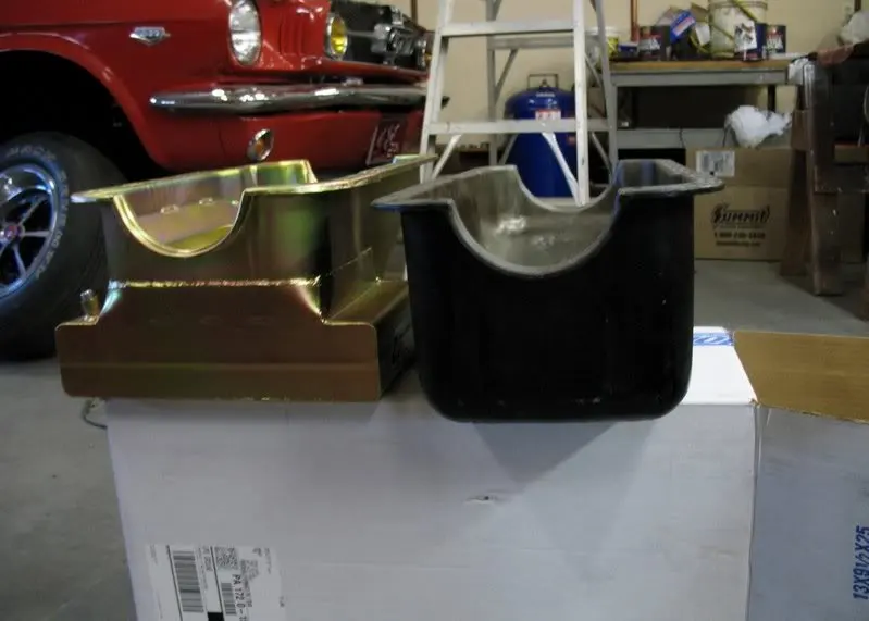

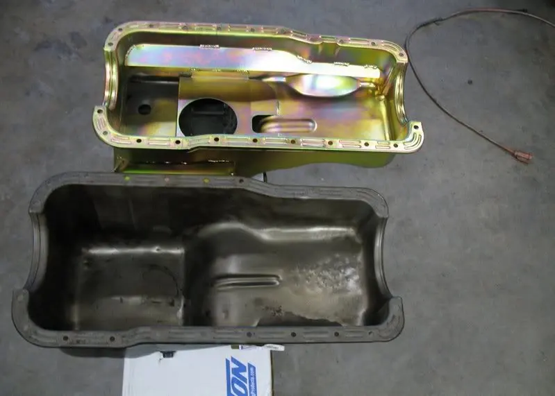

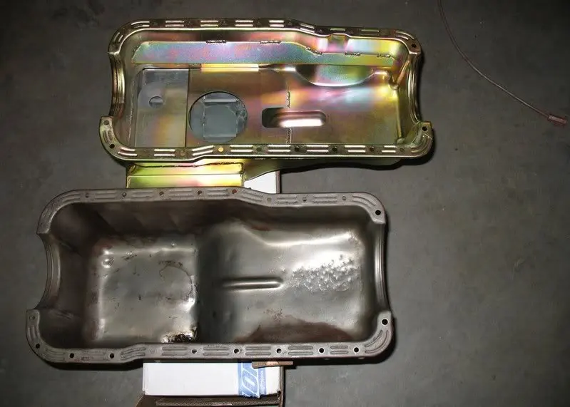

I happily discovered that the Canton pan was "stroker clearanced." It has a slightly lower rear drop, perhaps 3/16". Here is the old 351 pan that I had to clearance for the 393 (with the Ford windage tray) next to the 7 quart Canton:
It did take some heating and bending to get the Canton pickup positioned properly with the Ford windage tray. Hopefully a Canton windage tray matches better. I already owned the Ford tray so that is what I decided to use. It has its own crank scraper, that also needed some tweaking.
Not sure of the other pans, but the Canton ground clearance is excellent as its overall height is comparable to the stock pan.
The rear of the pan does touch the Lakewood scattershield's blocking plate. I didn't realize this until the car was assembled. So far it hasn't caused a problem.
