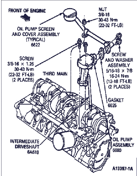

I know this may sound dumb to most people but do I put a gasket between the oilpump and the block? When I took this motor apart there was no gasket there and I have seen on a few threads that people said not to use them. Whats everyones opinion here?

Just an FYI, here is the image from my Ford Factory Service Manual for a 1992 Mustang 5.0. There is not supposed to be a gasket between the block and oil pump.

As long as the gasket doesn't partially blow out you should be fine. A partial blowout would be kinda like drilling a hole in the side of the oil pump. You won't loose pressure altogether but it won't be at it's max.
An oil system can have elevated levels when you first start an engine up and the oil is cold. Upwards of 80 PSI and beyond. That paper gasket that you put in there is the only paper gasket in the entire pressurized oil system in the entire engine. The small block Ford has been around since the early 60s and every one of them was built without a gasket there. It's makes you wonder why Ford chose not to put a gasket there doesn't it?
