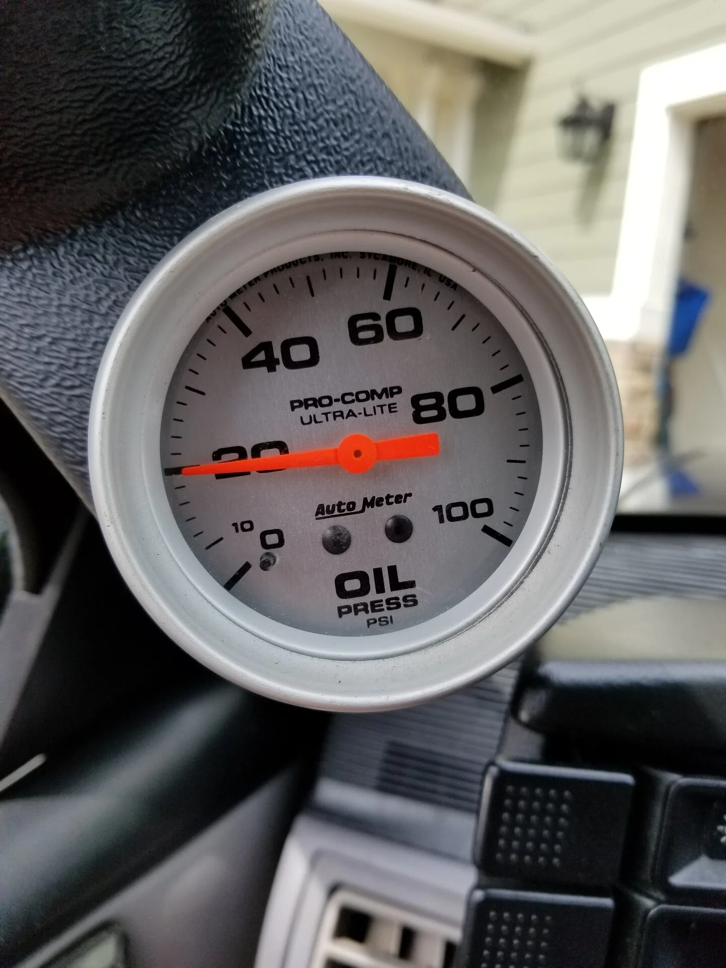

My 1993 mustang does something that is driving me a little nuts. It has a fresh built 306/AOD running a PimpXS megasquirt system. Car runs good, idles fine and generally has good oil pressure. I have the stock oil "gauge" and an autometer analog oil pressure gauge installed. When at idle, in Park and I shift into Reverse the idle drops slightly as would be expected but the "stock dash oil gauge" drops to dead zero for a split second and then right back to normal. Looking at my autometer gauge it has a very very slight fluctuation when this happens, but it shows good pressure. It kind of feels like the gauge thinks the engine is about to stall, but it isn't. I know I shouldn't have much faith in that stock dash unit but it bugs me that it does this. It seems like when the RPM dips below say 850 it has this effect on the gauge. It never stays at the zero for more than a split second. Anyone have any idea what might be happening?

I'm no expert but 15 psi on a new build would concern me, now if it was 100k+ engine I would feel differently.
Just for reference my 2yr. old 393w build runs about 30-35 psi hot idle with a standard oil pump, I know it's not apples to
apples comparison but I would think yours would be similar.
Probably has nothing to due with the brief drop in pressure on the stock gauge though.
Like I said I'm not a professional engine builder and don't know what bearing clearances you have so take it with a grain of
salt.
@Steel1 thanks for your input. It was a 100% gauge configuration issue. I had run a pipe up from where the sender screwed in, made a T so I could run the factory and the pro comp gauge both. Apparently it was too much because I removed my pipe and T and screwed the pro comp gauge directly in to the sender location and oil pressure improved greatly. This is hot idle. I am good with 20psi hot idle.
