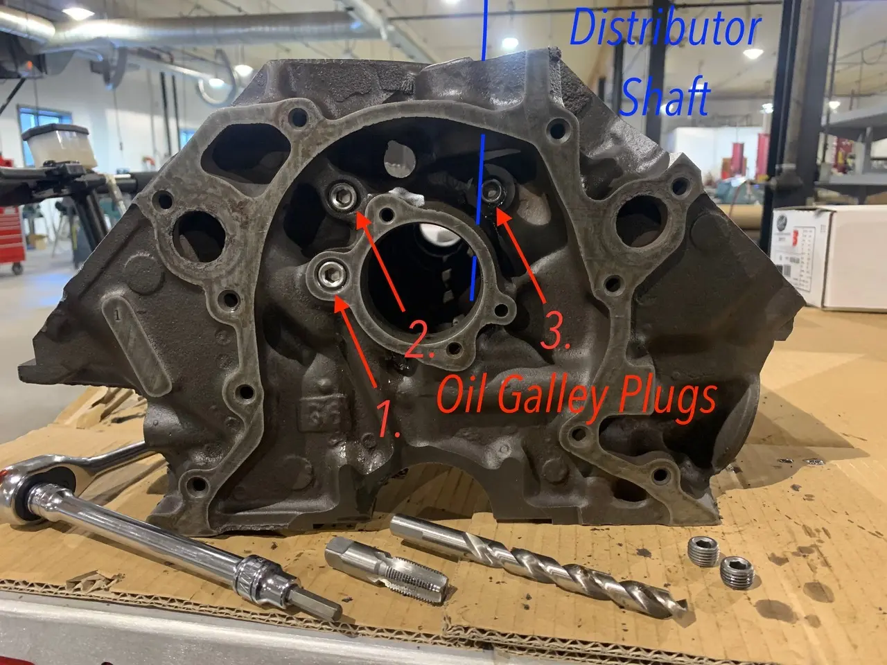

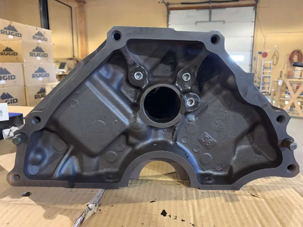

There are two oil gally plugs on the front of the block behind the timing chain cover and then a third one that you have to remove the distributor to see and install. There is one under the lower intake at the back of the block. There are three more at the back of the block. With all that being said if it was one of the three in the back of the block you would have a puddle under the car. The ones behind the timing chain cover and the one under the lower intake could be popped out and that would kill the oil pressure. The two that are the most common to come out are the ones at the front of the block and next to the cam shaft. The cam shaft retaining plate typically keeps them in but if one were to work loose enough it could let enough oil by to affect things very dramatically.The one behind the distributor is tapped by Ford and has a 1/4-18 NPT plug in it so really no need to worry about that one.
Rear of block (random pic of the web):
Front of block (random pic off the web):
On the Windsor blocks (1969-1997) the two right by the camshaft (1. & 2.) are flush like 1. in the picture so I am guessing this block is obviously earlier than 1969.
Overall odds of this happening are relatively low but every motor I have had built the three in the front and the three in the rear get tapped 1/4-18 NPT and a threaded plug with loctite gets installed in every one.

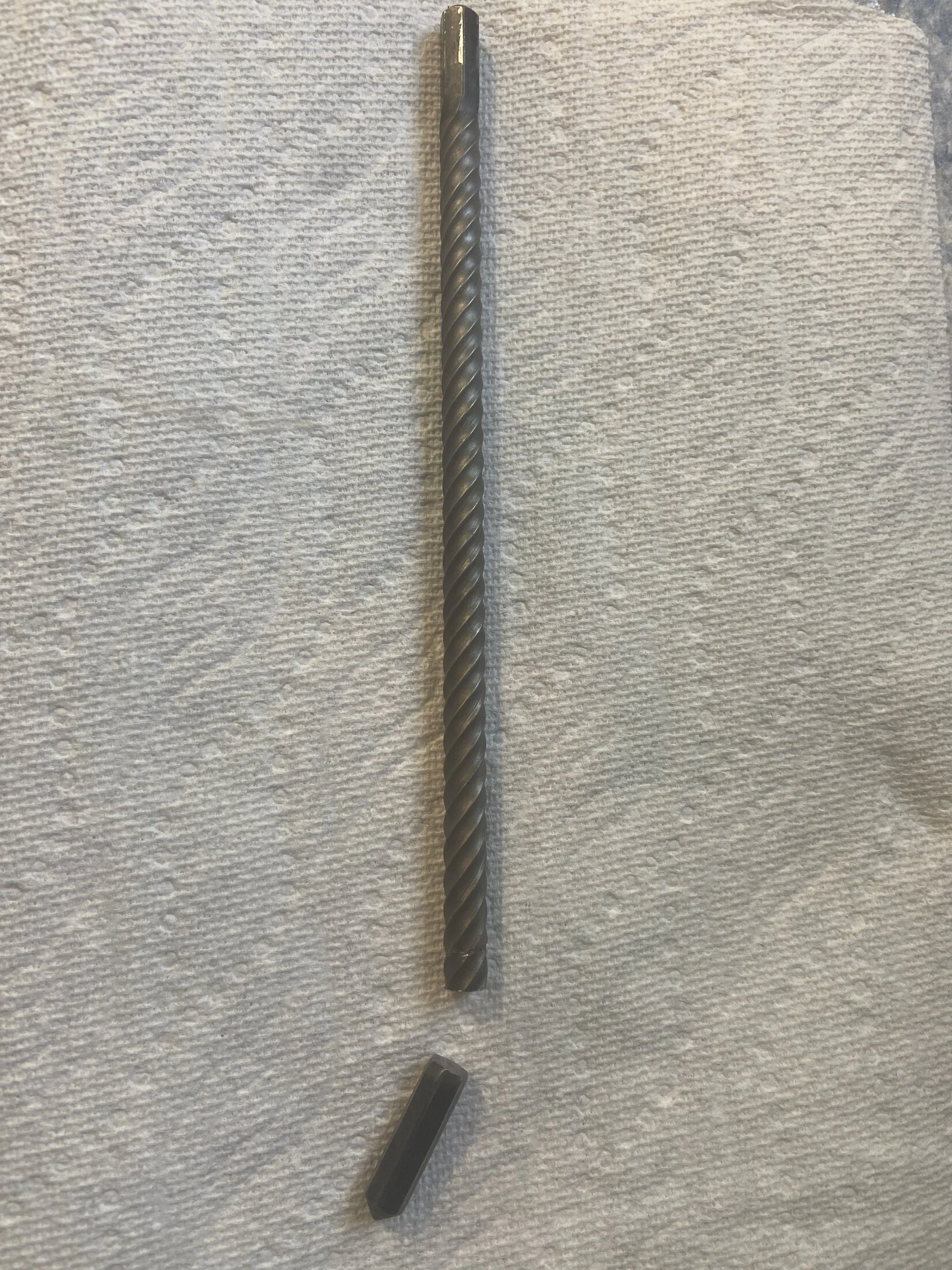

Hello again, I was Didn’t get around to more checks,,
Just did now and found this.
Twisted shaft, Broken an inch from the top.
Symptom now discovered
Recomended next step, before I screw anything else up??
And recommend shaft to buy as well?

I would say a locked up oil pump but you can buy a new ARP oil pump shaft and then try to prime it with drill. If it doesn't move then you have the pleasure of either pulling the motor or dropping the pan in the car to swap pumps.
