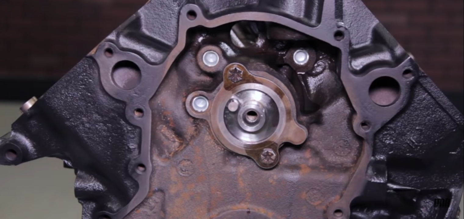

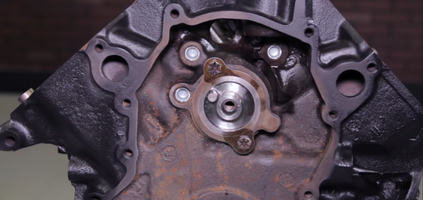

I just heard of 3 block off plates, little silver things and I can't find them anywhere. I have a picture of what they are. I didnt install them.

About the silver things - did you remove the existing pressed-in oil galley plugs to clean the passages? If you didn't, and it's your block (no one else messed with it) then the original plugs would still be there. It's not likely that. If you removed them and forgot to install replacements, it could be causing a big problem.

If you have zero oil getting up to the top end, it’s almost 100% certainty that there is one or more galley plugs missing. It’s Really the only thing that will make no oil come up. Even the gasket on the pump isn’t 100% necessary as those surfaces are usually very flat, not enough to not let any oil pass.

Look up a diagram of the entire oil system and you’ll see exactly where to check for the plugs.

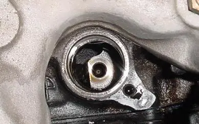

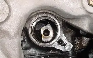

you run the engine for 10 min knowing there is no oil pressure ?????... good one .... its time to start again .. and by the way ..melling HV pump ..why is that a Rookie mistake ???? I run HV and HP pumps from Melling and no Problems ... if all good you can turn the oil pump Shaft by hand or with a hand tool and get Oil pressure in a Minute or less ... this pumps are making a vacuum turning them by hand and sucking oil .. and with a drill you should get oil pressure in seconds...if not ..there is something wrong ...:notnice::notnice: Youtube is full of Videos..how to do it right ... 1. take the Distributor out and check the oil pump drive Shaft sitting correct in the Hole and pump...

Pull the oil pressure sensor and run the pump again. Should definitely have oil there, I think it's right above the pump. My guess would be the oil gallery plug in the back of the valley came out. Mine blew out after a first start on a new rebuild once.

Thats a damn great idea. I appreciate the help. I definitely didn't taken any freezer plugs out or remember them being there. I'm the 10th owner on the mustang so I have no idea. I've heard of clearance issues with a better oil pump so I may need to add a quart more every time now.

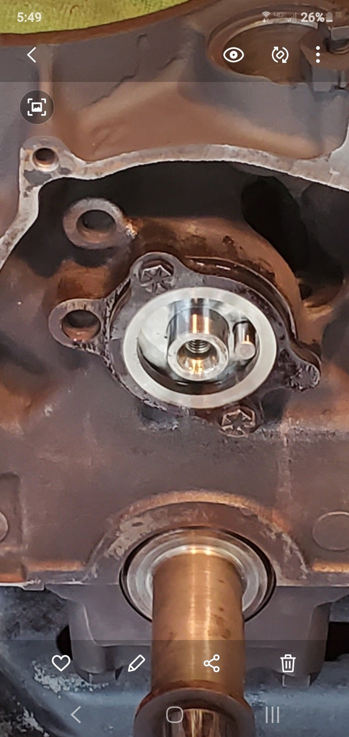

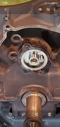

On a serious note now, you will have to check that all your oil valley plugs are installed( take off timming cover and look behind the cam sproket) take pics and post em. I hope there isn't any damage and you figure this out soon.If I was closer I'd help you out.
