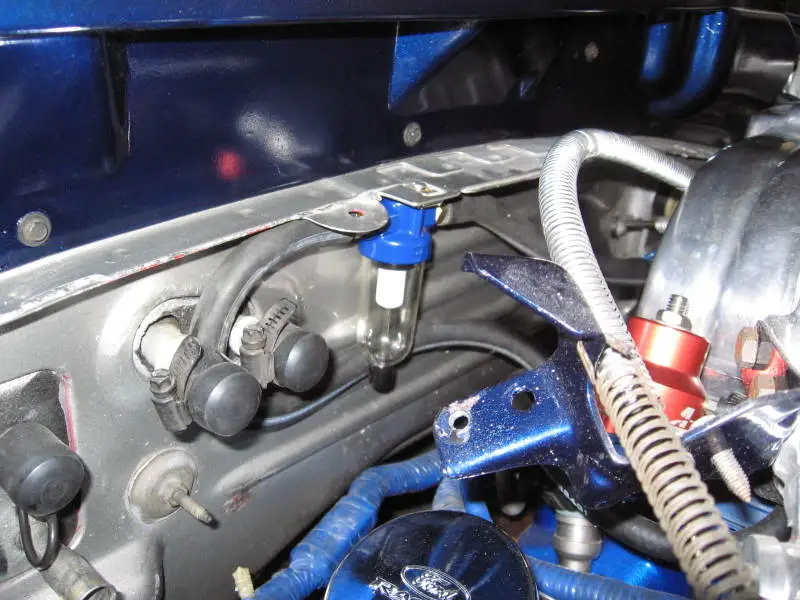

mine also is from home depot. I broke my element off(white piece in the filter) because I believe that is what gets clogged after time. I havent had any problems running synthetic with it.

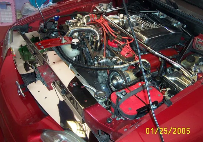

RC has his on the fender wall...What the hell?! you ran your hose all the way there to the back of the intake to PCV? I also have strut bar so i can't put it like the first pic...But i do "Need" to bolt this sucker down some where...
Actually mine is connected to the oil filler neck. the other end is connect to the power pipe. A shop put the hose from the filler neck down to the bottom of the engine bay to relieve pressure. The hose was sucking in air that was unmetered, so I connected it to the power pipe AFTER the air being sucked in was metered. Works well so far.
