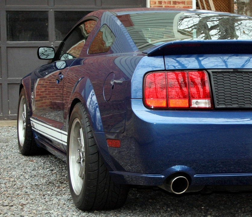

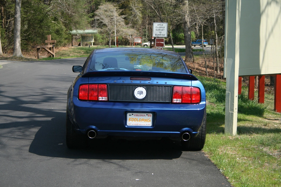

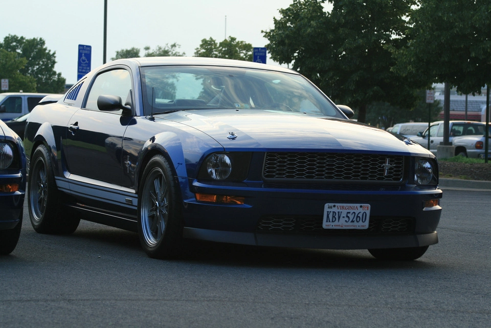

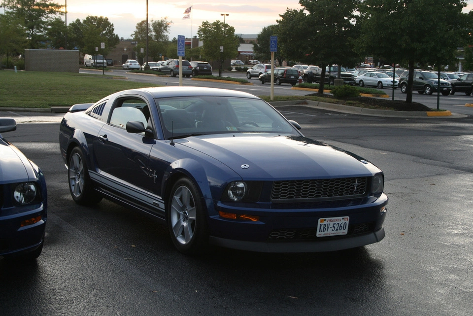

The 295/45 Nitto on 10" wide wheel puts the sidewall almost perfectly flush with the fender lip, but does not go past it.
...I need more money plus make up my mind on new wheels or not so I can get these 235s off the back, because this...
...looks better than this...
