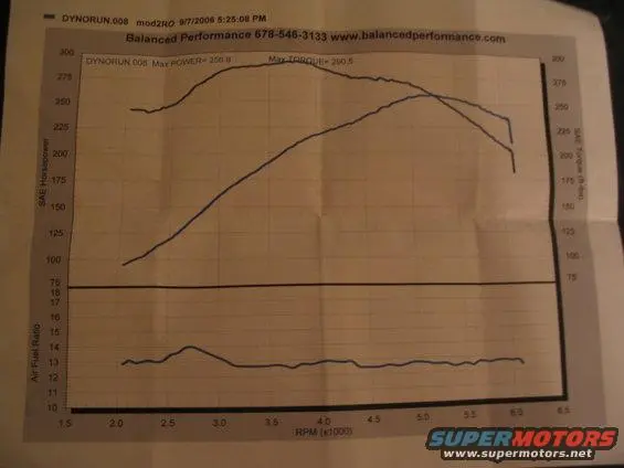

Ok here is the pic of my dyno sheet sorry for the bad pic. Ok, here comes the rant sorry in need to vent. Ok soooo you see the mods in my sig right well they are not totally correct. I bought a 73mm mass air from dugan racing and also got a used set of 24lbs injectors from them also. Well the guy who is doing my dyno tune called me today and told me that the reason that he has had so much trouble tunning my car is because I gave he the wrong info. Well my car is suppose to have the 73mm mass air and the 24lb injectors right. No he says. He said that he called ford and asked them about the part number on my mass air and come to find out that it is not an aftermarket like I thought but a stock mass air meter. He also said that my injectors are not 24 but the stock 19 lbs injectors:mad: . So you can imagine my anger right now. I had my brother and my cousin do the motor swap and put on all the upgrades so I know there is no funny bussiness from them. The only other thing I can think of is that I took my car to dugan racing and had them do my rear gears. So maybe they swap these items out and figured I would never notice:shrug: . But I know that when the motor got put in, it had the correct items on it. So I don't know but I am so mad right now:mad: . But let me know what you think about my numbers since now I know that I have stock injectors and a stock mass air meter. What do you think the improvement would be if I had what I was suppose to have? Thanks

Im sorry the numbers are hard to read. but I made 256.8 rwhp and 290.5 of torque. It all makes since now because he said that my combo was running real lean at first so he had to fix that problem and I of course lost hp. But maybe it would of been better with the bigger injectors right?
Thanks
Looks about right to me..I was 262 and 296TQ with bout the same mods and 19s...
Sucks to think a shop would bone you like that...:nonono: Somethings fishy for sure..

Your fuel curve may or may not be a bit off.
Most think anything below 13.00 to 1.00 is too rich but that is not always the case.
You said the tech fixed the too lean condition and the curve seems to show that.
As others have said, you really are not a whole bunch below the norm for what most combos like that put down and fresh parts like dizzy cap, rotor, wires, fuel filter and the like would most likely up the dyno values
