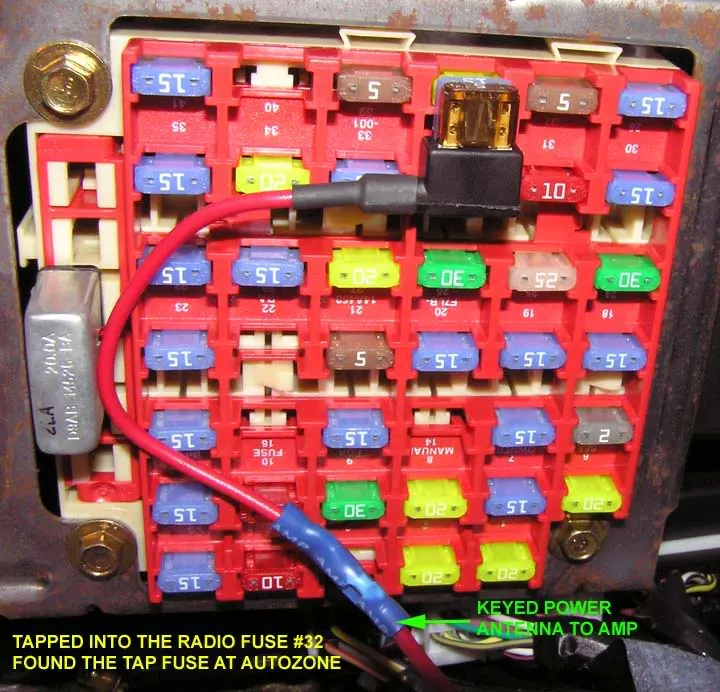

If all your speakers are being fed signal by the amp, then yes the amp remote power wire (blue and white stripe) needs to be connected to a key-on power source. You can usually piggy back it onto the fuse that controls the radio. Not sure which on it is for the '98 but I can post a pic of what I did with my '03.
One thing about Alpines, they usually are set from the factory with the internal amp inside the radio off. Alpine usually assumes you will power your speakers with external amps. Look over the handbook and identify which menu function you need to activate to turn on the internal amp inside the radio which will in turn make the speaker wires coming out of the back of the alpine hot.
