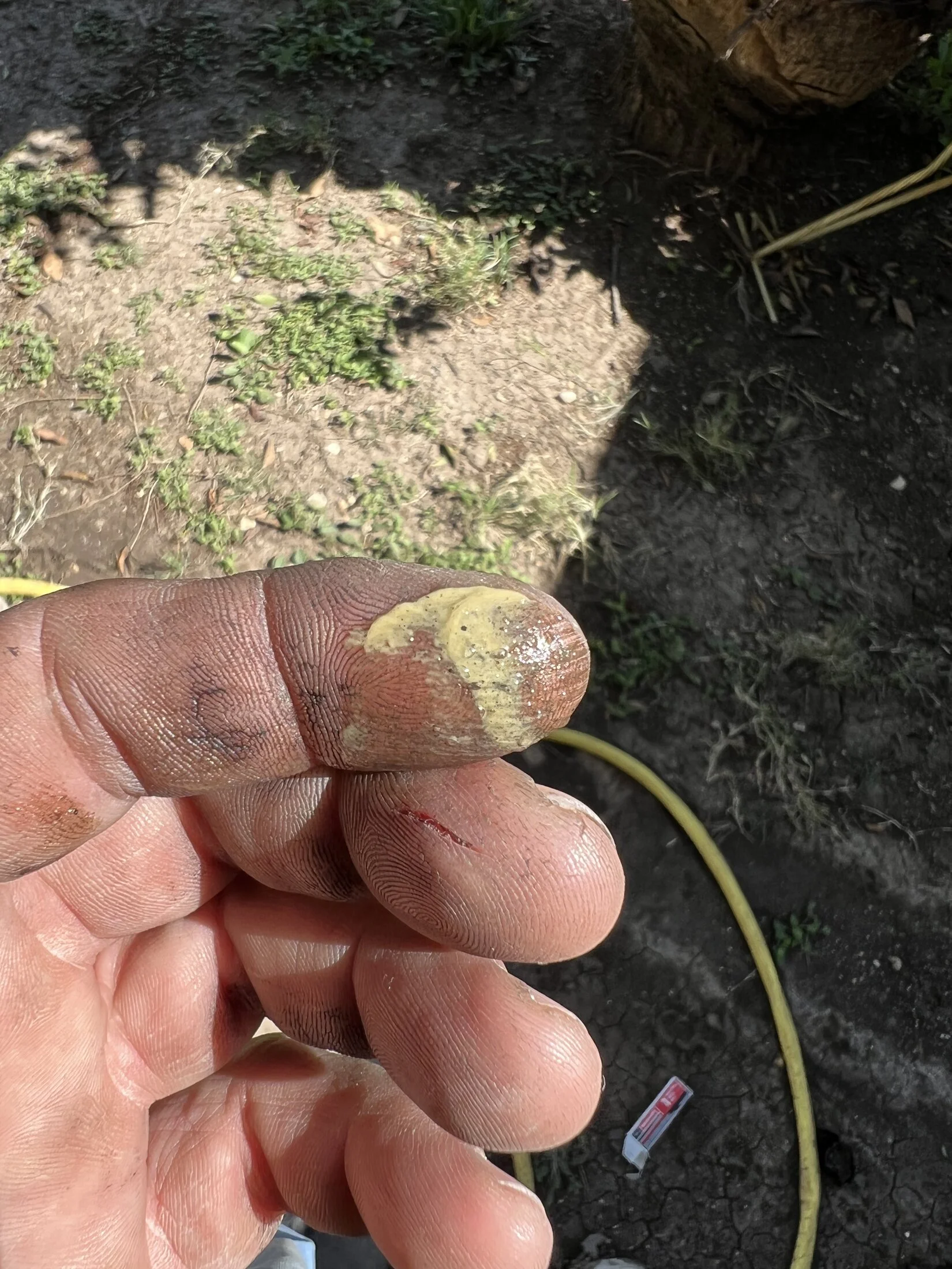

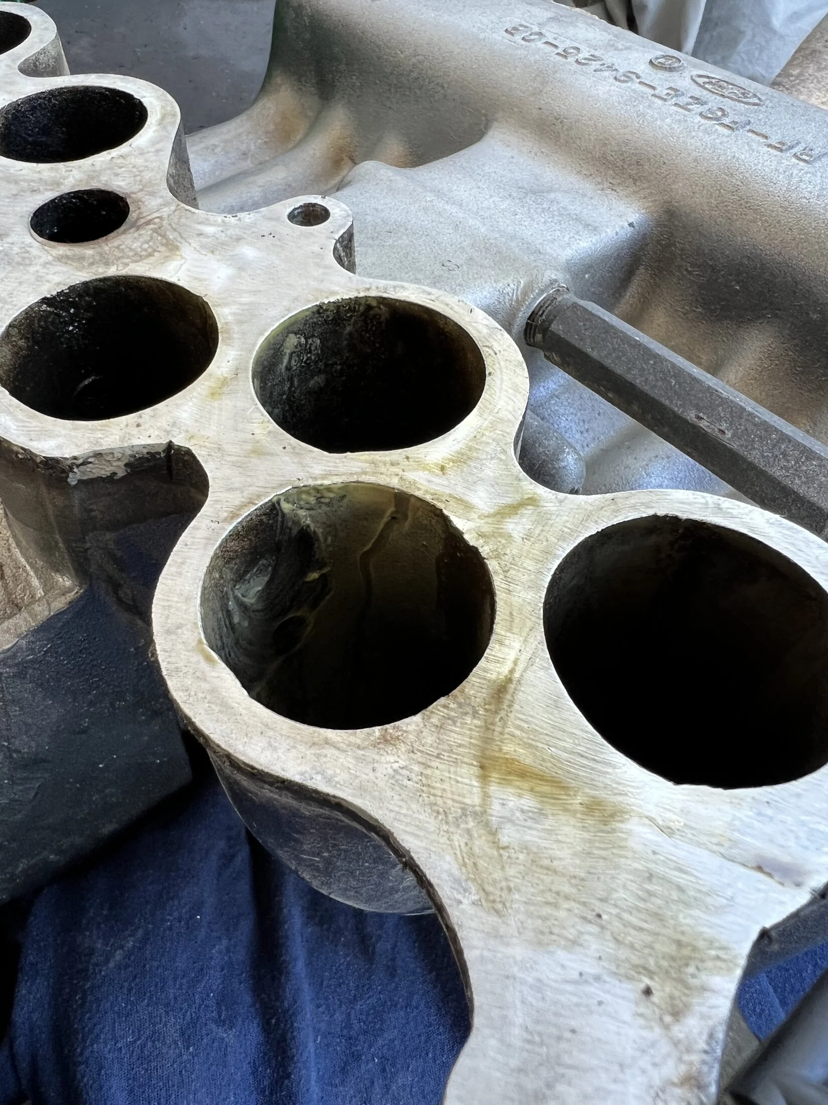

I’m not sure but I know I have to hold the pedal down to keep it on . I know the fuel is going somewhere. I did a oil change it looked normal but then again the problem just happened. I just installed new regulator ect sensor , checked tps only key on,.98 ,went over vacuum lines ,pvc, new spark plugs,I have 2 mustangs so swapped everything! Lol cap, wires, had tfi and alternator tested,swapped coil,not sure if this had anything to do with it but I did find a yellowish substance looked like Dijon mustard in lower and upper intake. Was assuming it’s fuel mixed with oil adding pics . Never seen this before but I do have a vacuum leak at brake booster but have been running car like that no issues but this won’t let me drive. Sputters as if I had plug wires swapped or something but I keep thinking fuel pressure cuz my other car holds pressure for hours this one seconds

That's oil and condensation or water... Gets forthy like that until its cooked off see it alot on oil caps when ppl only drive short trips.. You have coolant running to an egr spacer still or a catch can on the pcv lines? Might be a small leak or its sucking that from the pcv and your getting water some how, possibly gas from the regulator but you said its new and gas doesn't tend to froth like that when it mixes with oil..

Damm I sure hope it’s condensation. The oil didn’t look frothy. No catch can on pvc,and no coolant to egr. Trying to read fuel gauge with car on but scince car wants to die the gauge going up and down with the rpm of car diying

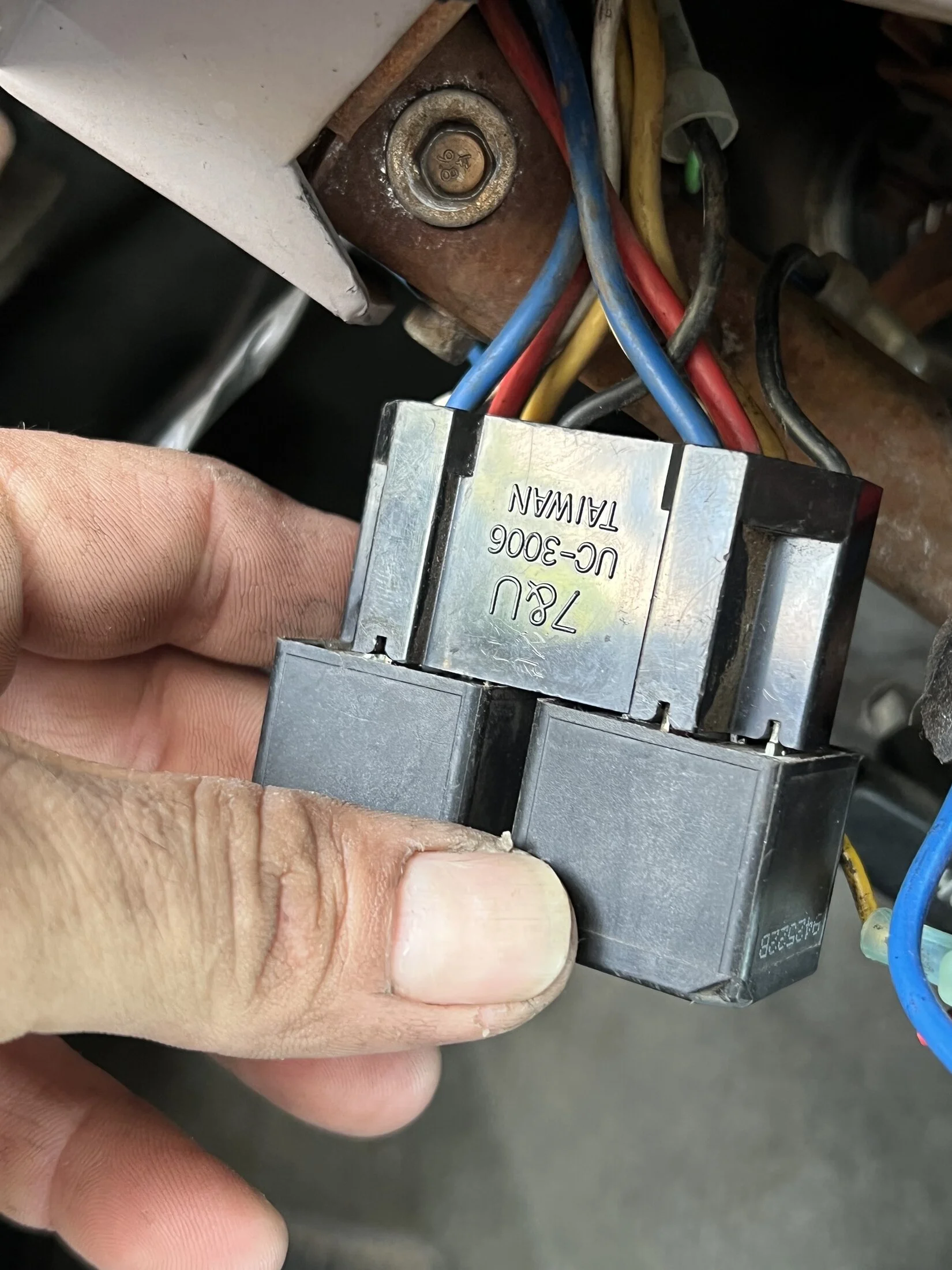

You need to chase those relays down and make sure they are not part of the problem. We would put an interrupt on the fuel pump trigger wire on cars back in the 90's when we installed an alarm so that the car was inoperable when it was triggered (not snowflake triggered).
Lol there was corrosion on those relays,probably going to replace them and see what happens if it fixs the problem then I’ll eliminate them .
